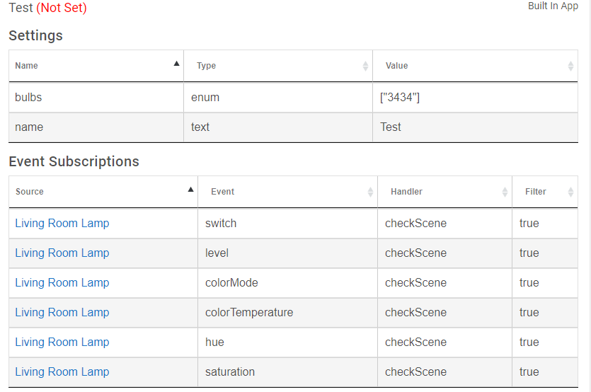

Here are the scene settings.
And the current values for the 1 device in the scene.
As you can see, they match the scene settings. This happens with Hue CT bulbs, Sengled directly connected RGBW bulbs in CT mode and Hue integrated RGBW bulbs in CT mode. It does not happen for bulbs in RGB mode.
