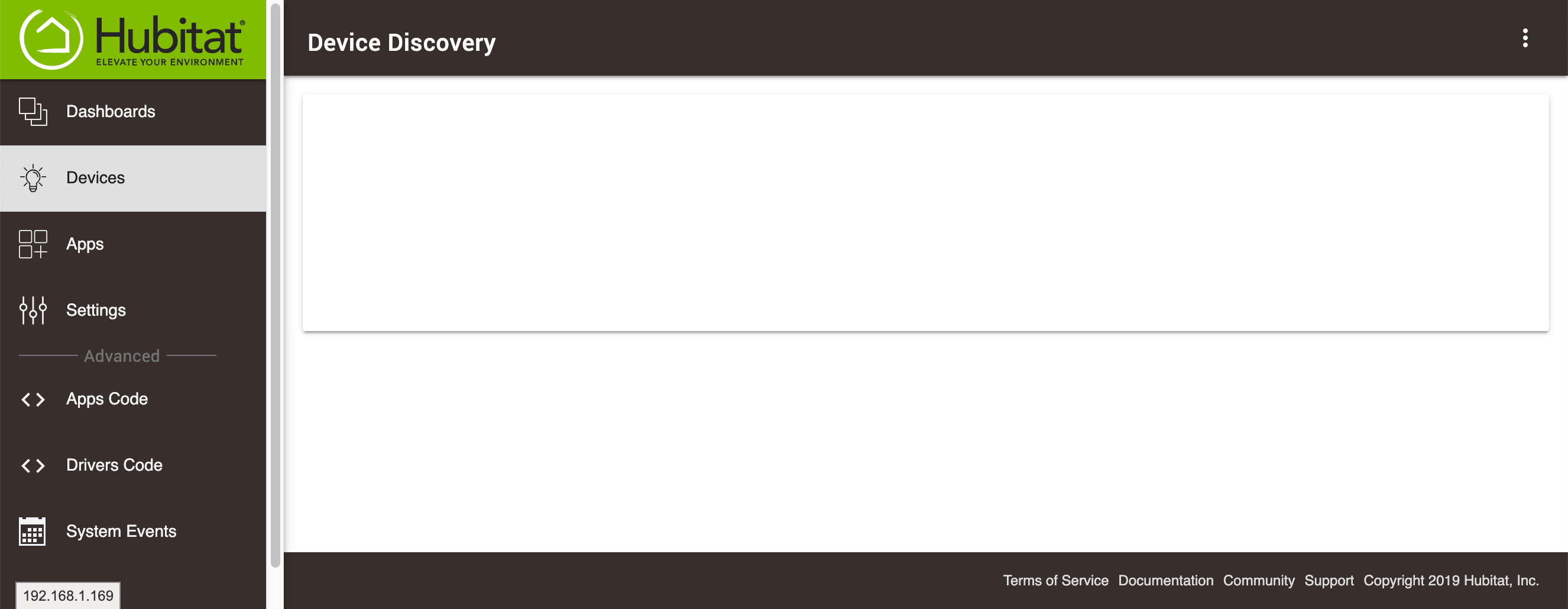

I wanted to add another device today and went to the Discover Device page. It was blank except for a white rectangle. I checked for updates and saw build 2.1.0.123, which I upgraded to. The Discover Device page is still blank.

Would you mind sending me the the exact error in chrome, f12 or developer tools, in the javascript console. Chrome works fine for me and others. Don't know about Brave, it's not a supported / tested browser.
Feel free to post or PM me a screenshot of the exact error when you are on the discover page while developer tools are open and refresh just to make sure the error shows up before taking the screenshot.

I disabled all of my browser extensions and the Hubitat interface loads correctly in Chrome. After playing with the extensions, it appears that the Fake Data browser plugin is the culprit today. When I disable that, the error in the developer console disappears and I can search for new devices (in both browsers).
