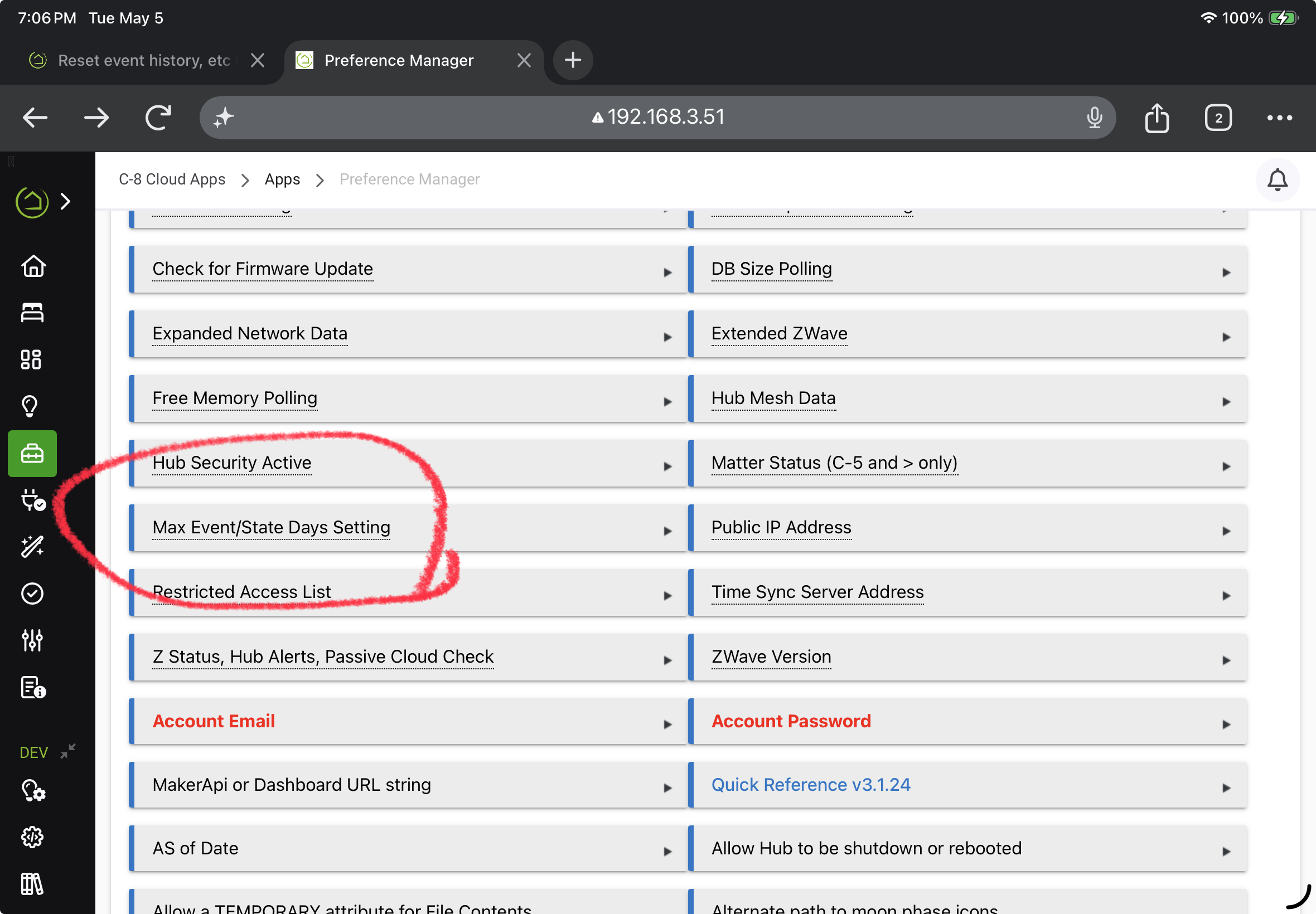

Easiest way may be to install the built in Preference Manager app and adjust the Max Event/States Days.

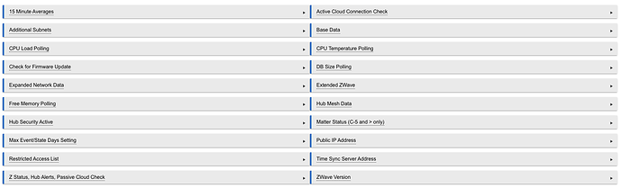

I'm not seeing those settings in the list of Preference Manager app... am I missing something?
If you go in by Preference Name
Nope.
Is there some place you have to enable advanced preference visibility?
It seems like it shows preferences based on devices/apps that are installed. Possibly you have some other app exposing that setting that it's reflecting? Like I don't see "DB Size Polling" or "Check for Firmware Update" etc.
Those two are from the Hub Information Driver, the Event and State Days should be a universal one.
Installed Hub Information Driver v3 (and created Virtual Device), no sign of those fields. Also installed the app, same. =/

There now, up top. Had to reload the preference data in the Preference Manager
So definitely need the Hub Info Driver to make these show up.

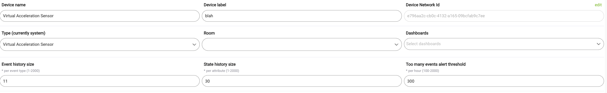

Just reset a hub and got it up and going.
Looks like it's 11 and 30. Which seems low... I do seem to recall it being much larger in the past.
