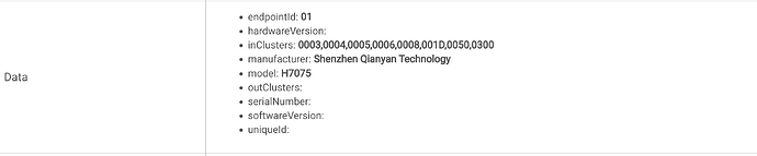

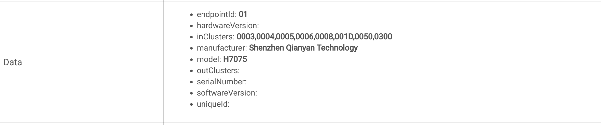

Do you know what the matter clusters are for the device? If you add it to Hubitat it should provide a list of the clusters detected. Once that is done then it could likely a driver could be created. I created a driver for a Matter Fan device not long ago.
Add the device to hubitat and then scroll down to the bottom. Take a snapshot of the data section so the inclusters are show like this.
The inclusters show what functions the device supports. That example is a light device. Your air purfiier should have a different setup of clusters unique to air purifier devices.
