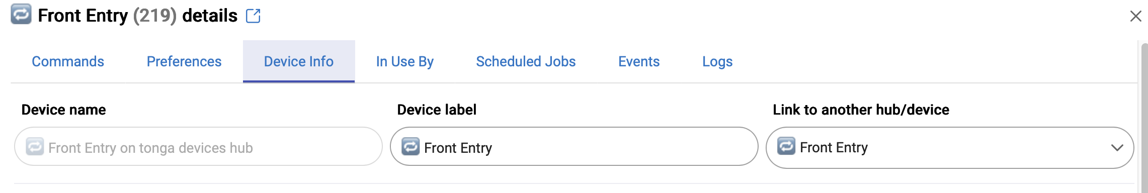

When I mesh a device to another hub, the Device Name on the receiving device has the name DEVICE on SENDING HUB NAME. I then manually copy the DEVICE part and paste it into the Device Label. Reason is that the Device List looks better. :face_with_open_eyes_and_hand_over_mouth: Can anybody think of a way to automate this? Yes, I am that lazy.
