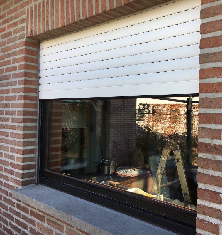

I don't need any half open/closed option, it's to fully open or fully close roller shutter... don't know if that's the right word... in my lang it is called " rolluik "

think you would call them blinds? roller shutters? i don't know...
I did had a look-a-like device that was wifi based but having 10 of them clutter my wifi
