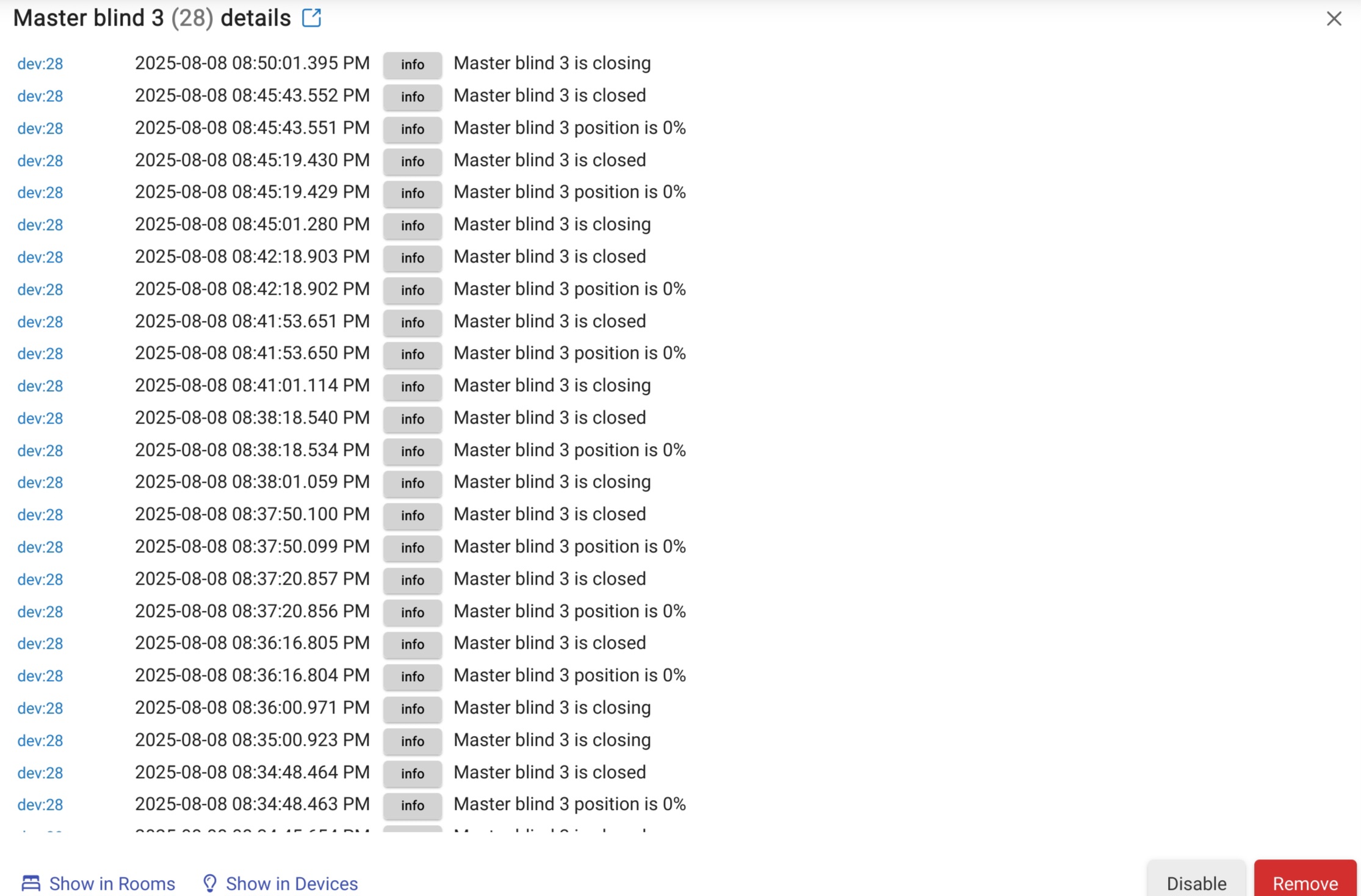

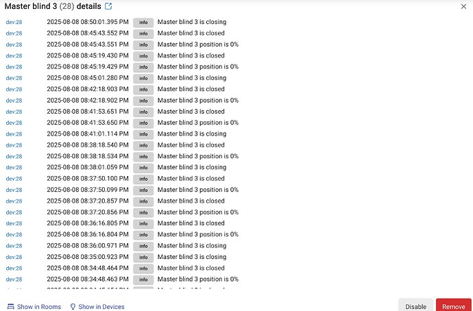

Running on my C8 pro. In my logs for my blind (generic driver) I'm getting a bunch of commands that seem to be unnecessarily repeated. Command retry is ON, but it seems to me that once the hub is told that the blind is closed it still continuing with additional commands.
The blind is closing. But why all the additional commands? In addition the last status ended on "closing", but it had already been closed. I hit refresh in the device and it immediately updated to closed. Is command retry messed up?

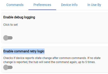

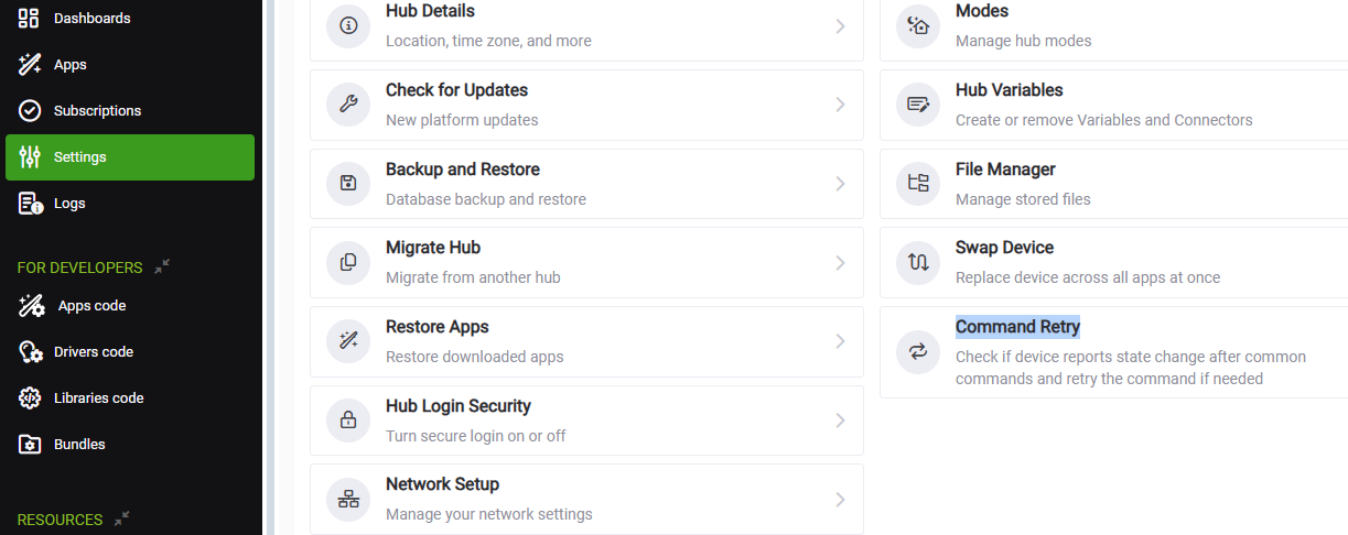

Turn off : Enable command retry logic on any device you want.
Or you can turn it off for ALL devices.
I understand that I CAN turn it off, but I'd rather not. As I understand it, if a command is missed it should only get resent if it isn't acknowledged by the device. That's doesn't seem to be what is happening here. Commands are being resent regardless of their acknowledgement. Furthermore the status ended up showing "closing"... After it had already recognized it's status as being closed. Something is wrong.
It may still be worth turning off command retry for that device to see if it is actually causing causing the issue. With the info provided it could be an automation or even the driver. If you turn off command retry and the behavior stays the same then you know 1 thing it’s not.

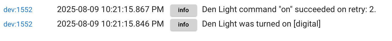

I've had to turn Command Retry off for several devices so far. I continually am getting warnings that things have failed after 5 retries, when in fact, the device responded to the initial command just fine. Perhaps not fast enough for the command retry to notice it, The first two devices that I noticed with this issue were my Radio Thermostat CT-100 and my Yale YRL216 Z-Wave Lock. Both of these are Z-Wave, and they are both very slow to respond.
With locks in particular the initial delay for retry is 5 seconds and it backs off with another 5 seconds with each subsequent retry, so it should have caught the first one well before the five expired. Are all your locks doing this?, or just one

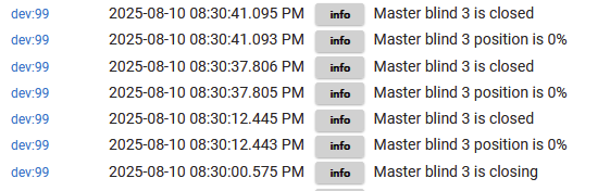

OP here. For those of you keeping score at home, as punishment I decided to make some changes to see if it made any difference. In yesterday's experiment I changed all my blinds (16 of them) to LR and to disable Command Retry. Excluded them and re-added them. Fun. Here's the log from last night when the same Rule Machine rule was executed (close blinds at sunset):
For the record I made no changes to the rule that closes the blind. Maybe this makes sense to someone out there. Maybe not.
So it looks like you are seeing the same behavior w/o Command Retry. So we have eliminated 1 possibility. To see if this is simply the driver, i’d enable debug logging and open and close the blinds manually, no RM. Just 1 is fine no need to do this for 16 blinds.
Also what is the make and model of the blind and what driver are you using?

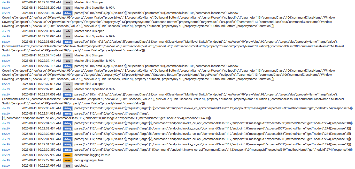

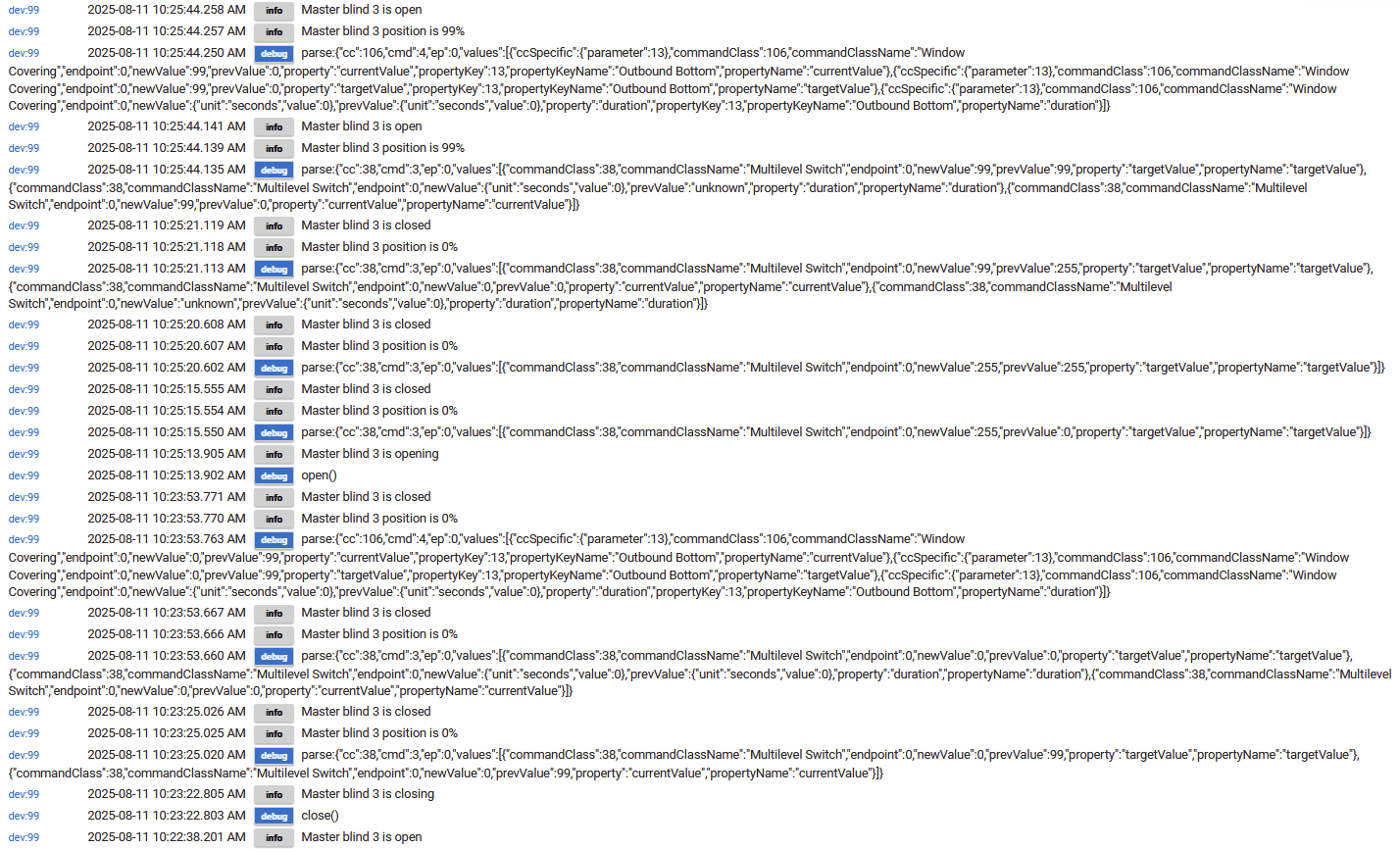

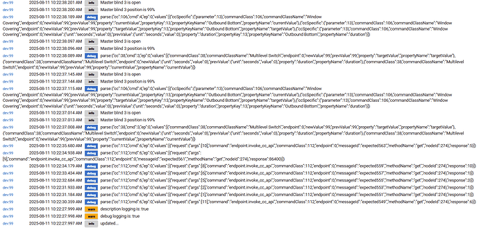

Thanks. Debugging turned on. Blind open > closed > open -
Blind is from SmartWings and the driver is the "Generic Z-Wave DT window covering"
When adding the device, it defaulted the driver to a multilevel switch. I changed it to the Generic Z-Wave DT window covering. Seems logical, but probably a wrench in the works.
You see those parse entries? they are the driver responding to updates sent by the device. They seam to match the info entries in the log. In this case everything looks to be working as expected. I see no errors or indications of an issue.
Unless there are additional symptoms that have not been mentioned, i wouldn’t be concerned. the logs look fine and expected behavior. You are welcome to change driver to see if others are less verbose, but less verbose doesn’t necessarily make it better.

Ultimately the blinds work and that's all I really care about. The thing that sent me down this hole originally was (quoting my original manuscript):
"...the last status ended on "closing", but it had already been closed. I hit refresh in the device and it immediately updated to closed."
Does it matter? Not really, probably just an anomaly. But the boss saw the status was stuck on a dashboard. She wears the pants. Thinking my life can go on now. Thanks again appreciate the help.
