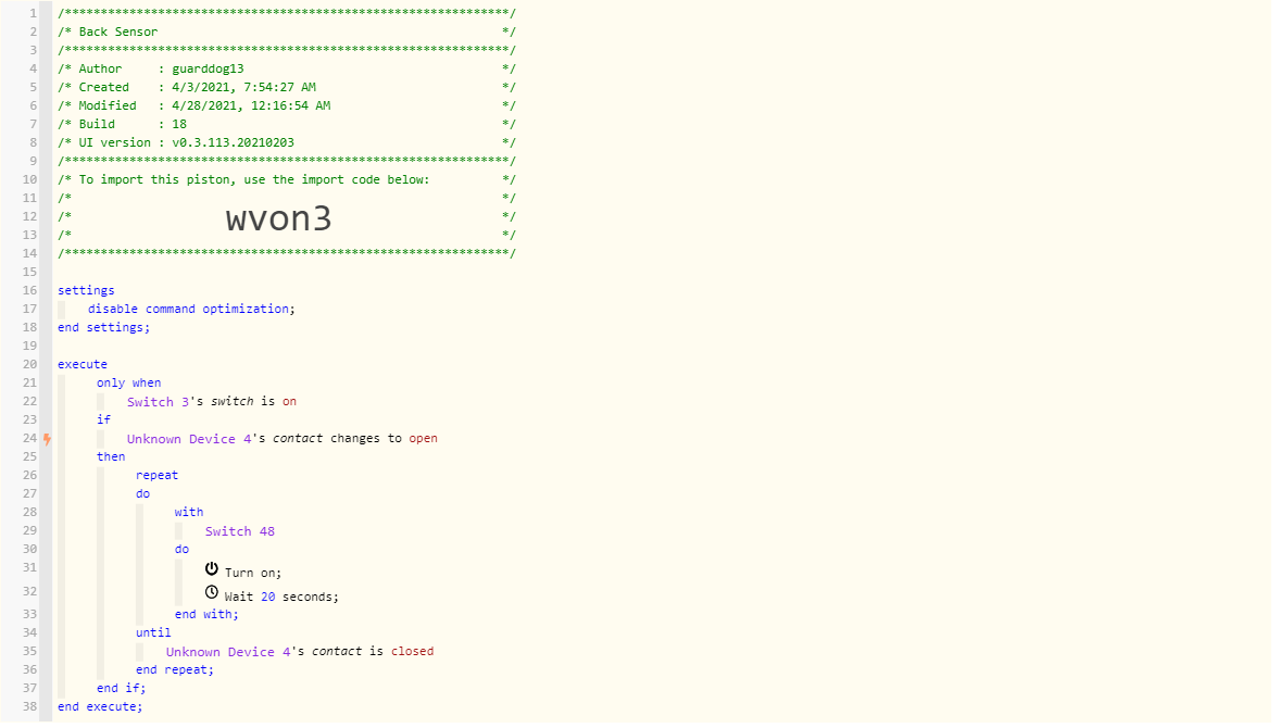

So I'm in the process of moving my webCoRE pistons to RM. I have a question about repeating.
So in webCoRE I can set a repeat until and once that until is met it automatically stops what's happening. For example I have my own DIY alarm system. When the Security Alarm switch turns on it casts a 20 second file on my Google Homes. I want this to repeat until the door that's open is closed, see Piston example below. I tried doing this in RM and can set the repeat until but the casted file continues playing and always repeats at least once before it stops. I tried creating a separate rule to stop repeating actions and this partially works as the file will stop automatically. It will, however, still complete one more 20 second repeat though at the 20 second mark from the first set of actions.

I attempted to do it this exact way last night. What happens in this scenario is the 20 second file will finish playing it's 20 seconds. Meeting the until condition doesn't stop a repeat action dead in its tracks like the piston does I have posted above. If i set a rule like that and have another one that tells the Google Homes to stop based on the contact closing it stops immediately. However, the repeat rule will run thru one more repeat and only then will it say oh the door is closed now I can stop.

That's going to generally run through one more repeat because you're checking it right as the repeat finishes (when the device is likely to still be in the same state), not before (or right after) it starts again. Any of the first three examples in the thread I linked to above show how to handle it in a way that won't do that, assuming this is concerning that issue:
The below example the repeat doesn't stop.
Right. As in the examples, you need either a simple condition (IF) on the repeat or a "full" IF THEN/ELSE inside the repeat.
