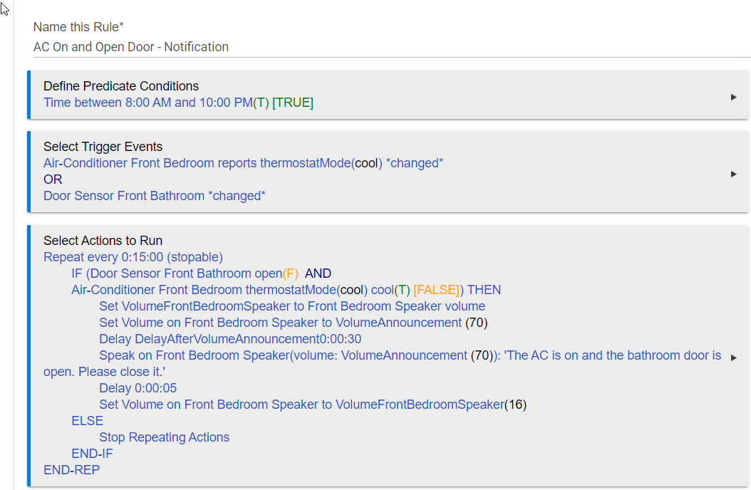

Hi, could anyone please tell me what's wrong with this rule? What I'm trying to accomplish is to be able to announce I forgot to close the bathroom door in the bedroom when the AC is turned on and the door is open. If I close the door or turn off the AC, the repeat should be stopped but it's not at the moment.
Repeats not stopping is a known bug that will be/is fixed in the upcoming hotfix.
https://community.hubitat.com/t/rm-5-0-stop-repeating-actions-bug
