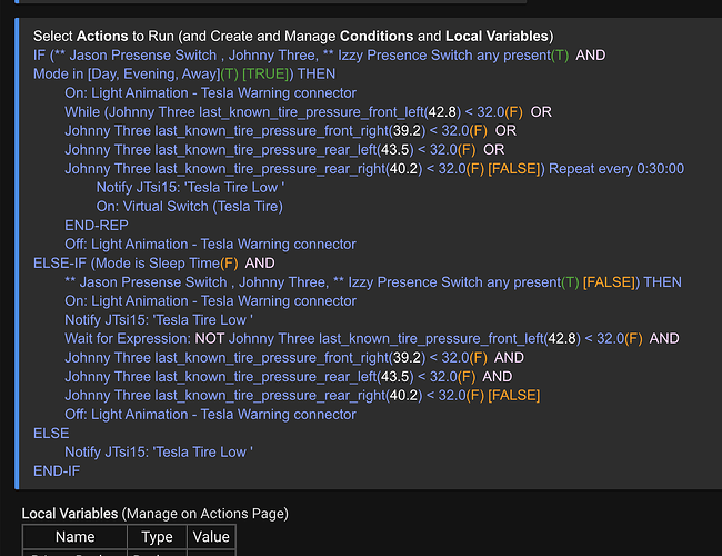

Im attempting to clean this rule up and try and figure out a better way.
Does anyone see a better way to write this rule?
The warning is dependent on modes and presence to the home.
The Virtual Switch (Tesla Tire) is an Alexa announcement in the home.
Triggers: IF ANY Tesla Tire is below 32 psi of Air pressure.
Goals: IF someone is home and the mode is NOT(Sleeptime):
Repeat//
ON: Virtual Switch (Tesla Tire)
Notify: JTs Phone
ON: Tesla Warning Connector
IF someone is home and mode is (Sleeptime) then:
Notify: JTs Phone
IF noone is home then:
Notify: JTs Phone
One thing I would do if remove the Required expression. It adds no value over the trigger.
