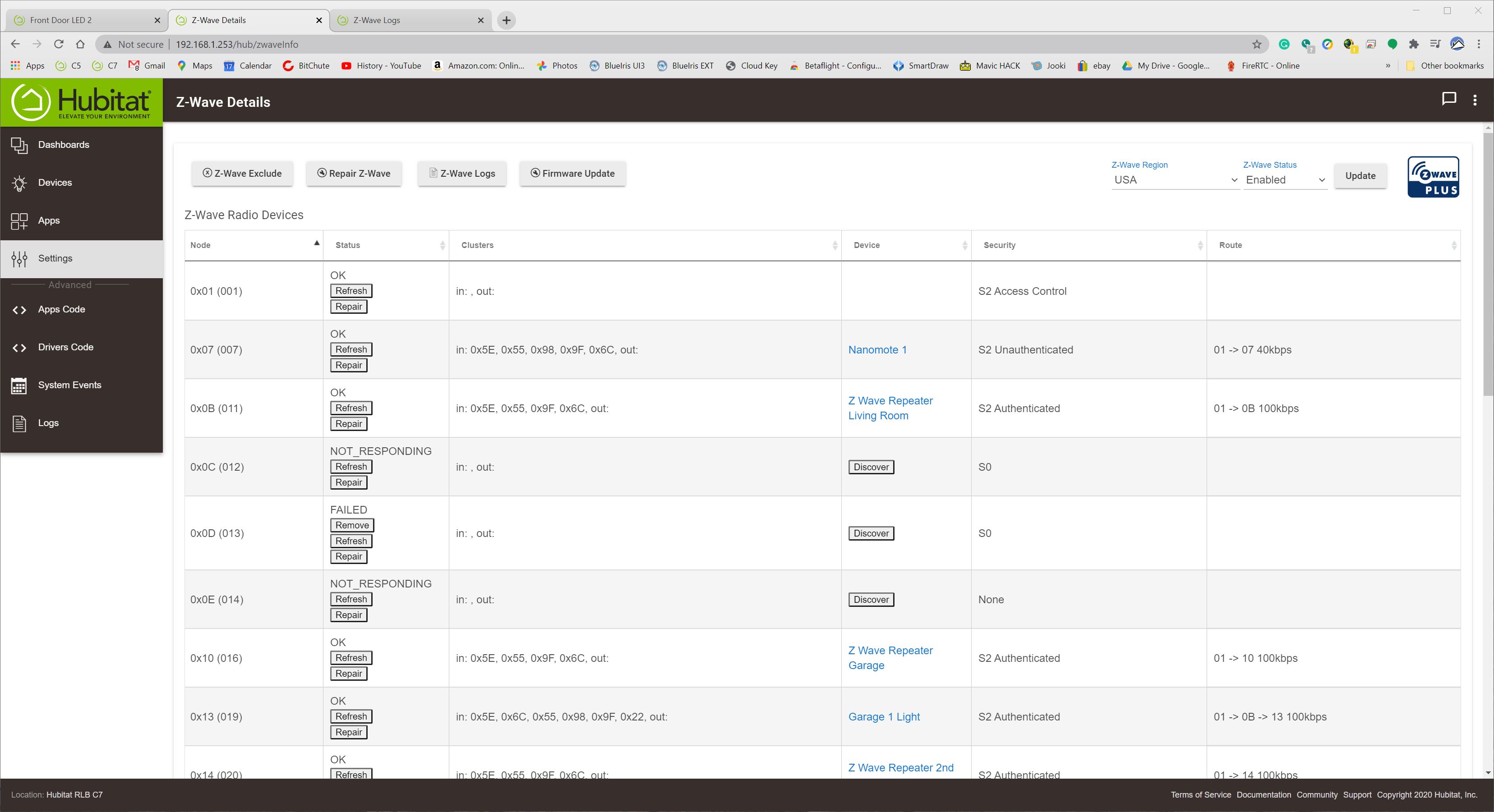

I have two Not Responding and one Failed node in my ZWave Details page. It also looks like working devices are routing through these nodes. Under the device column they show the Discover button. How do I get rid of these items?
I'm pretty sure they came into existence when I was pairing Inovelli color LED bulbs and was having trouble including them. I tried shutting down and resetting as advised in an earlier thread from August.
*I eventually was able to add the LED color bulbs so now I cannot attempt a DISCOVER as the devices already exist on a different node.

newbie here as well w/ a slew of "failed" / "not responding" ghost devices... from what i've garnered from other posts you're supposed to be able to hit the remove button and it should go away.
that said, i've tried that, and it hasn't removed them. but i've also seen enough posts regarding the C7 hub and z-wave issues that i suspect this is lower priority on the resolution chain and we should just hold tight w/ these spurious entries in our z-wave table. (i think all of mine are already duplicated as actual devices so i'm not super concerned)
the Discover button is there in the event you haven't actually re-added the device you can open a new browser tab to z-wave discovery - start the process and then click the Discover button and it will then be discovered. Actually pretty neat if you find you had a device that you were including and failed to get it discovered/added fully in the 60 seconds. this button will resolve that.

reboot hub and try the remove multiple times.. sometimes it takes three or 4 and if the device does not have a remove on bootup try refresh and repair then remove when it shows up .. last device took 2 repair cycles on boot before it removed cleanly. Also remove in the zwave does not remove the device in devices..
once it is gone in the zwave details remove the device from the devices page.

It wouldn't bug me so much but I am having some issues that I believe may be surrounding this. I have 3 Inovelli color bulbs in outdoor fixtures that should come on at sunset, off at sunrise. The bulbs almost never all go off or on (I'll see two on, one off) and they're usually routing through one of these nodes I'm trying to delete.
