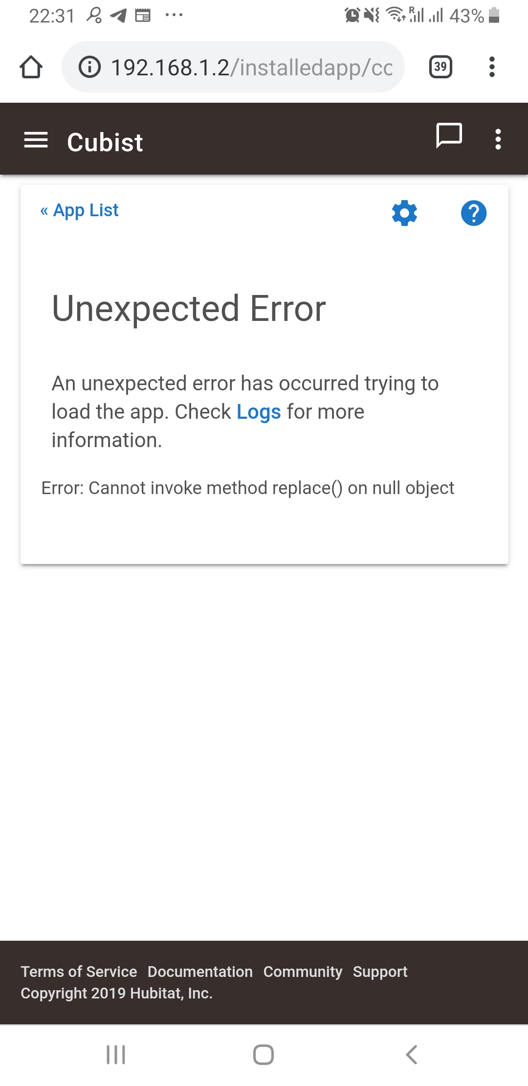

FFS seriously?
Really looking forward to a day with this system when I don't get an error doing something simple.

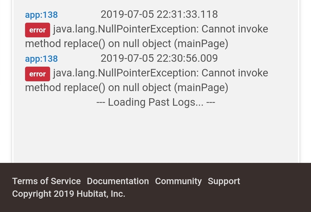

You didn't really say what you did, just posted a couple screenshots (none of which were the app as originally configured) and said that a device was "referenced," so I tried a couple things to see if I could get this to happen to me.
First, I created a new Button Controller 3.0 child with a virtual button device as "Select Button Device" and set up some actions. Then I deleted that button device. I was able to go back into the Button Controller child app with no errors; as expected, the button device was just missing. If I chose a new one, everything else filled back in.
Since that worked, I did something similar but referenced a device in the actions that I then deleted. In this case, I get the same error as above. I only get this with "standalone" Button Controller 3.0, not the "Button Device" trigger in RM that uses the Button Controller UI. RM will give me "**broken action**" here.
As a workaround, if you want to delete devices without first removing them from automations they belong to (probably the ideal state, but I confess to not always doing that myself), using a "Button Device" trigger type in RM will effectively give you the BC 3.0 UI (not a "Button" trigger, though you can do effectively the same or more with that and just use the regular RM UI). Long-term, if BC 3.0 sticks around as-is, it would be nice if it either gracefully removed the device like most automations do or put in the same "broken action" hint that RM does.

Update: Further to this, since both of these errors involved .replace()
I have protected all such references in Rule 4.0, and will do so as well in Rule 3.0 and Button Controller 3.0. These fixes, to all three apps, will be in the next release,.
