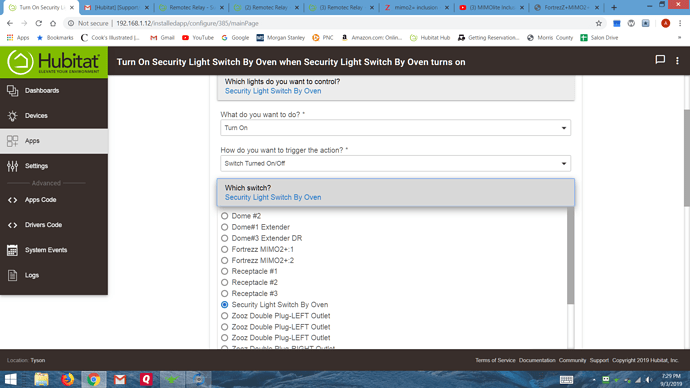

I changed parameter to 3 but it didn't work. Here is something. I have a MIMO2 and just included and it shows up in the device list and when I open the SL and it asks What switch? The Remotec never showed up but the MIMO is there. When I setup the app What Light? Security Turn ON. Which switch?
It should be the Remotec, right?
Wait...hold on....the "other relay" you talked about is a Mimo 2? Then you don't need the remotec at all. Just trigger off the Mimo2.
I was trying to get the Remotec to work. It is strange that I didn't see it in the list in the app but the device list shows it there. Am I correct thinking that in SL the swtich is Remotec or MIMO if I chose to keep the MIMO?
Sorry, you've lost me.
This is what I meant. MIMO is there but Remotec is not but in devices it appears. So Which switch? Should be the relay either Remotec or MIMO,correct?

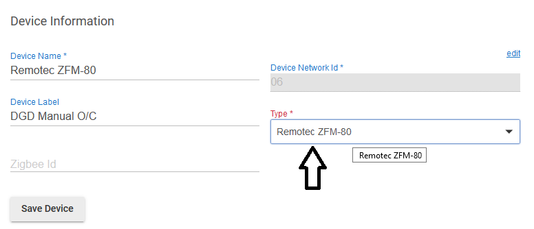

Did you change the Type back to ZFM-80 on the device page for the remotec.
Ok I changed to Remotec when alarm relay made contact with trigger switch the security lights came on and stay on . I even changed Device to turn off in 2 mintues and that didn't work either. Parameter is 3 value 3. If I turn off alarm relay then turn back on the light goes out.

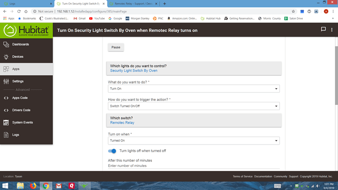

You are almost there. It is because the remotec has a strange sequence to how it turns on and off. Could you show your rule so we can determine what to do to get the remotec to send the correct signals to your lights. So when alarm goes on lights go on and when alarm goes off lights go off.

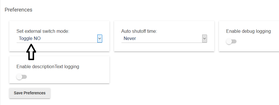

You also might try to set this parameter on the remotec device page and see if that works.

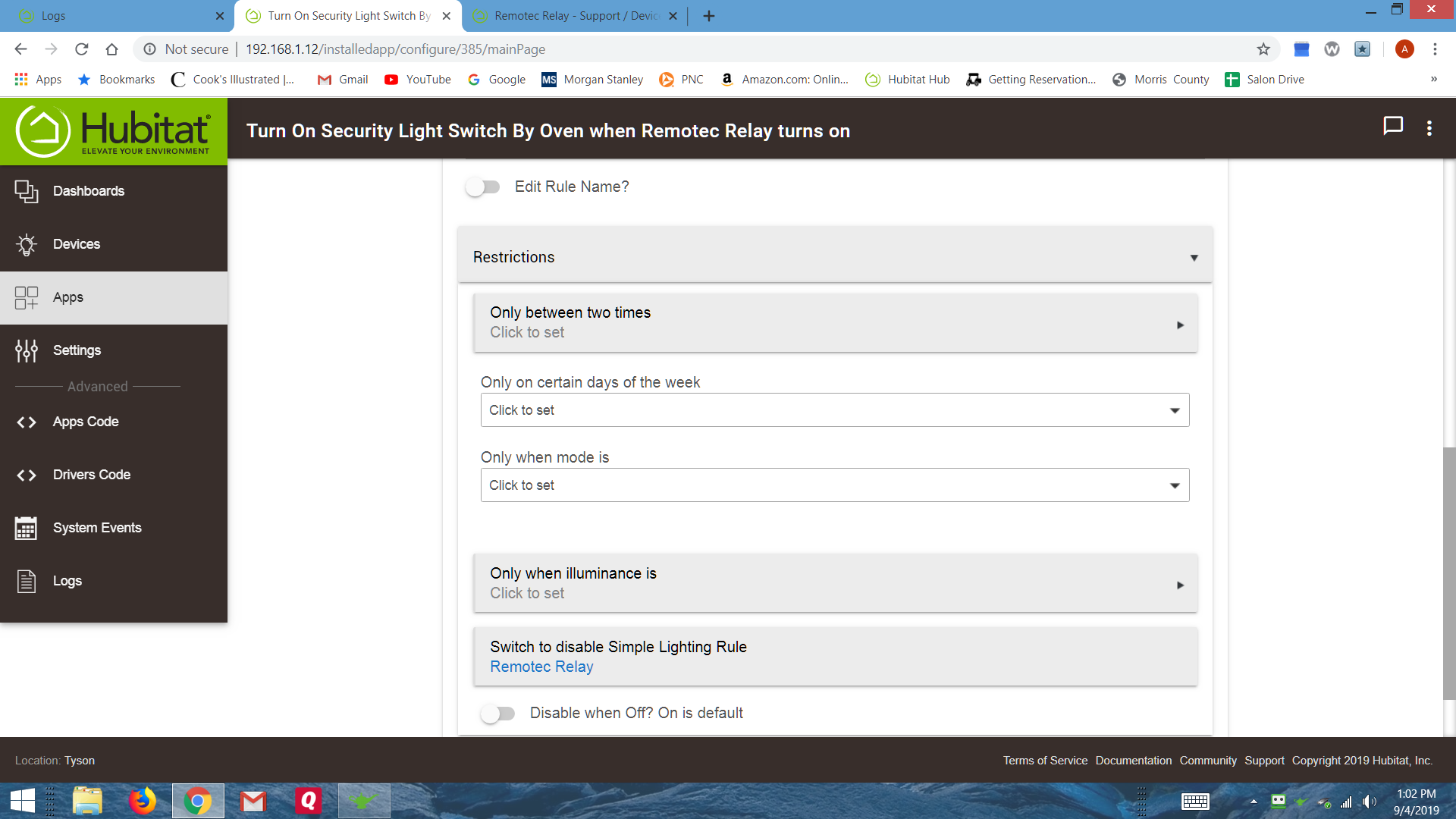

You will want to remove the remotec from "switch to disable simple lighting rule". Then on the second picture where there is "turn lights off when turned off" there is the part that says "After this number of minutes" that is where you would put a 2 if you don't already have it there.
FINALLY SUCCESS! Thank you Razorwing and Ryan780. I can't wait for a burglar now to break into my house. Ha!
