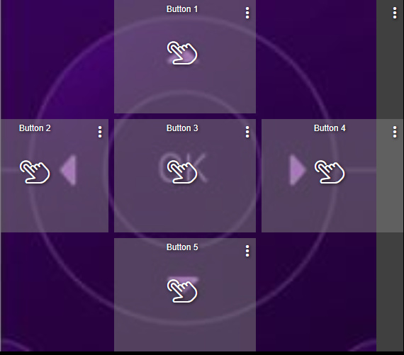

This is the closest I could get to what you are looking to do.
If you want one tile that will do different things based on where on tile you press, I don't believe that's an option.
EDIT: A wacky workaround you could do is 1st create an image tile that is 3x3 with that image of the button that you shared. Then create 5 1.x1 buttons, 1 for each arrow and one for OK and place them on top of that part of image tile in your dashboard. Setup the button template to be transparent so that you can't see them and you will only see the image tile behind. Since you created the button tiles after the image tile, they will be on top.
I didn't make the button tiles completely invisible for illustration but something like this:
