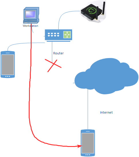

I tried tethering using my cellphone to computer. Connected to websites but not the hub
Yes, because the hub was not also tethered to your phone.
The hub was either offline totally, or connected to your home router which had no internet access.
No internet for the hub means no cloud/remote admin.
Your computer being on cellular connection means it has no access to your local LAN.
= No way to connect to the hub with that setup.

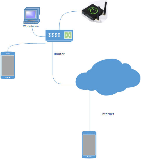

Let's try this:
Yeah I was looking for a good one of those. And then @junk7001 sounds like you tried this at one point. Which hopefully my updated diagram below explains why it did not work.
Pretend those things that look like an ancient tablet are cell phones.
Visio 2010 LOL
