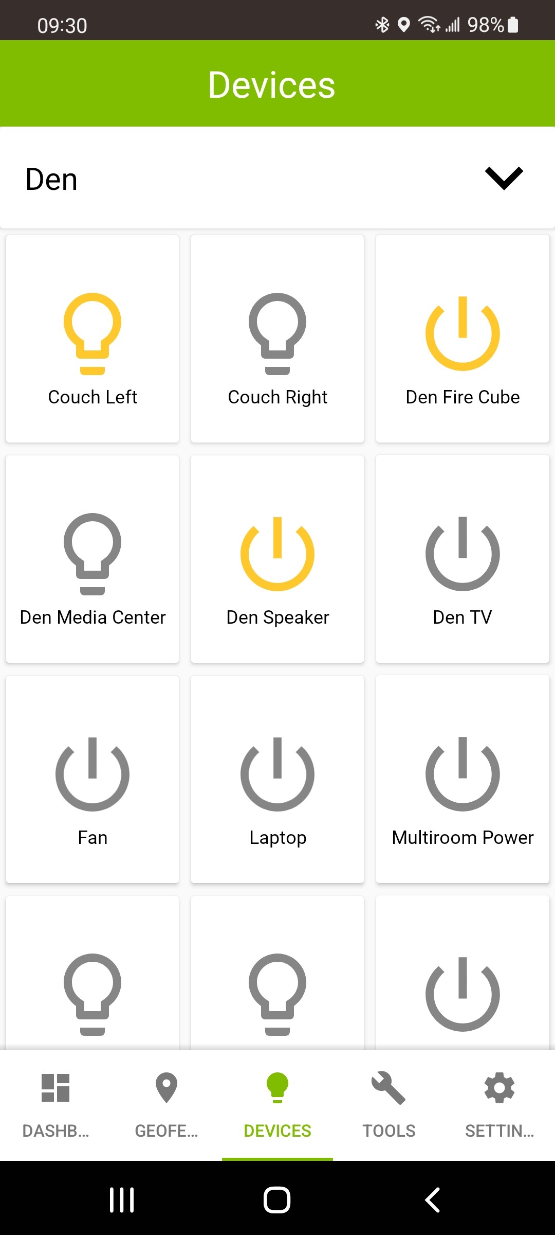

There is an android and iPhone app for Hubitat that provides access to the devices by Room as well as access to the dahsboards you create within Hubitat. It is quite functional, reliable, and unlike the other platform, allows you to define the functions you want access to on more complex devices (via the dashboard).
Only displays switches and lights currently...
