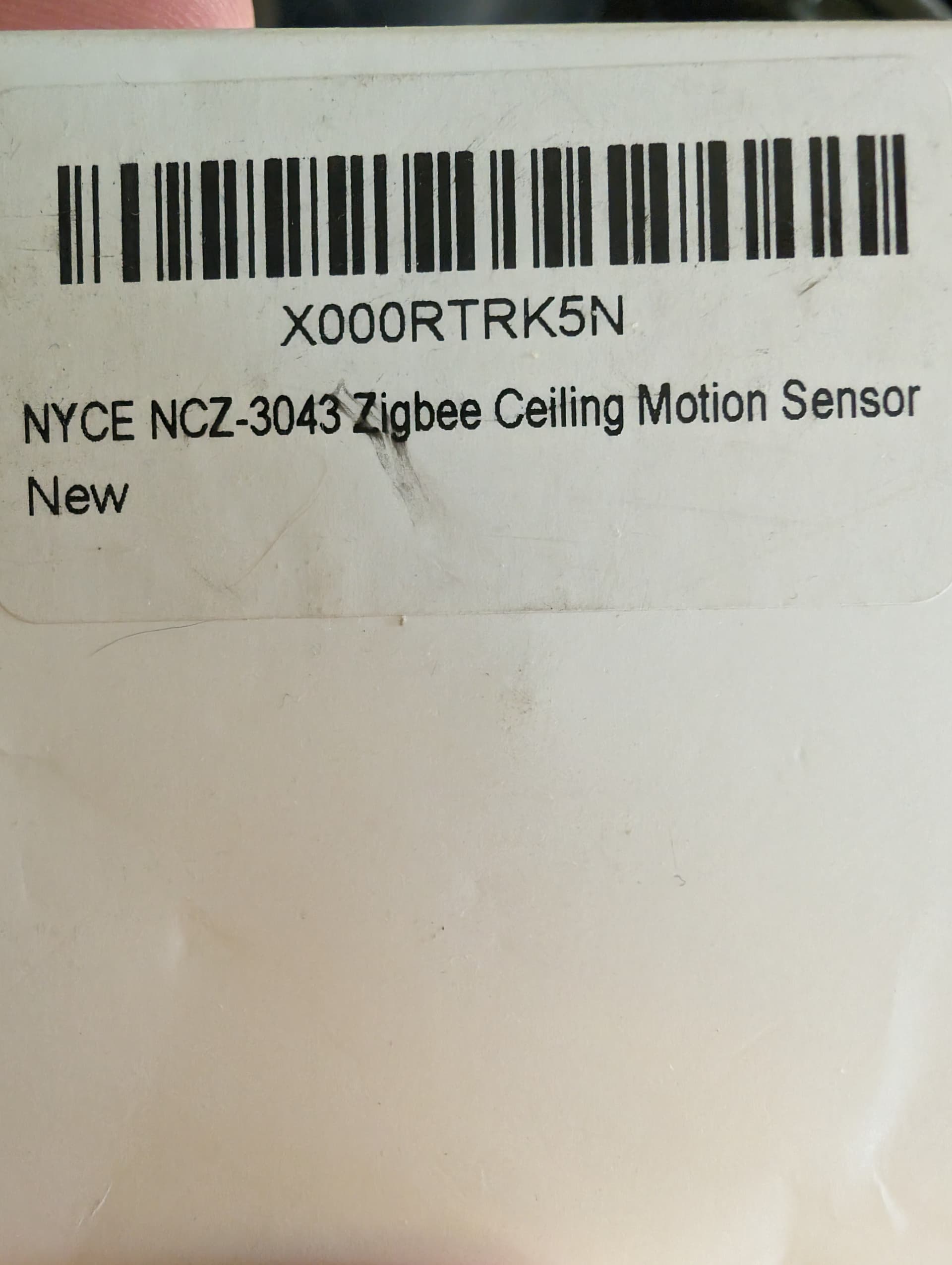

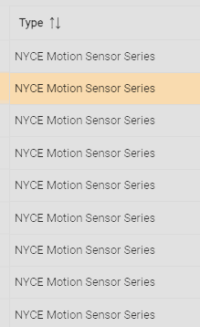

I have bunch of these and they all are acting the same, seem like I might have bad batch? I did buy them all at the same time

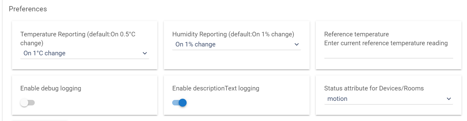

It's hard to believe they didn't show problems from the beginning. They do have adjustable sensitivity. Are you using the built-in driver, if so which one?
That is really odd/interesting...even if you got a "bad batch" it seems very unlikely they would all start having the problem at the same time, without some external change affecting them. As noted, these Nyce sensors have long had a strong following due to responsiveness and long-term reliability. Not saying you're wrong or anything, it's just an interesting and pretty odd experience. That would lead me to look for something that changed that is affecting them. :man_shrugging:

Bobby - I don't see a motion adjustment option in the stock Nyce Motion Sensor driver, just for temp. Do I have the wrong driver?:
2024-02-28 09_02_15-Hubs, Network, & Tech
No, but if a custom driver is used, that could set different param.
