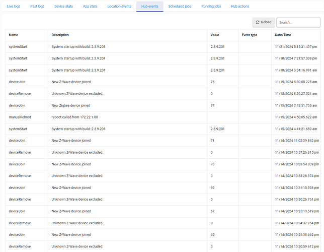

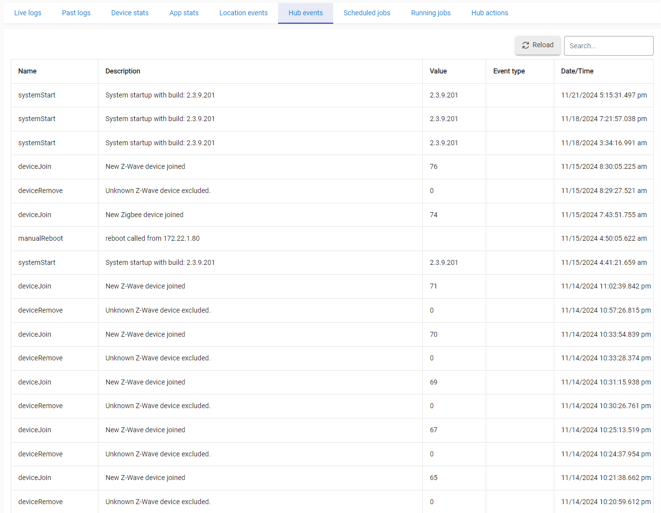

Logs: Attached is a screenshot of the event log showing the frequency of these crashes (reboots):

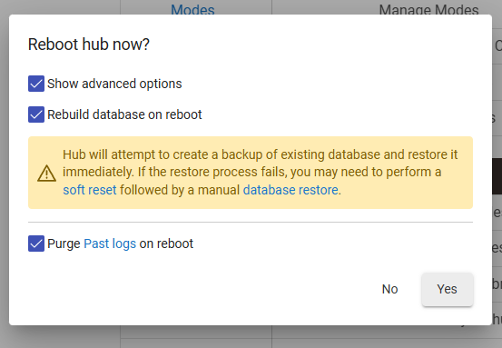

Did you try a re-boot with rebuild - database checked ??
LOL. I have reset it to a factory default, and reconfigured it from ground up.

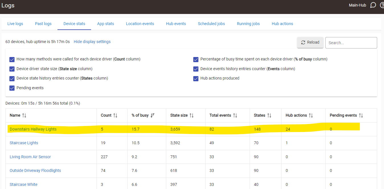

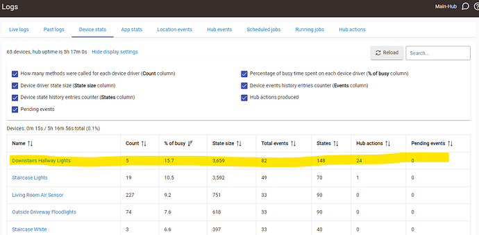

You have 54 devices. It may take a little work but I have a hunch you will locate a faulty device. Start by removing 3-5 devices. If the hub no longer crashes then you know your problem is within those 5 devices. Then add one back in and wait to see if the hub crashes. Repeat until you find the problem. Humor me and give this a try and then post whether or not it solved the problem. I would be curious to know.
I performed a complete reset on all devices before re-adding them to the hub. Upon reviewing the logs, I observed that one particular Inovelli switch appears to be putting significant strain on the hub.
I've always disabled power/current reporting for all Inovelli switches, but I'm going to start by addressing this specific one.
