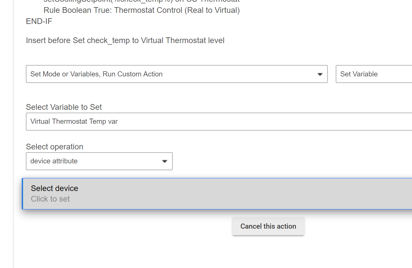

I think I stumbled on two bugs related to setting variables. One, if I try to set a global variable from device attribute, the dropdown fails when picking a device. Seems like a graphical glitch, but it does cause a broken rule.

I don't understand what you mean by "dropdown fails". In your screenshot it shows. Please explain.

You can see in the last screenshot, that when I've tried to use a global variable, the only reaction when clicking the "Select device" dialogue box is that it gets a blue shadow. If I choose a local variable from the first list, then this works just fine. My virtual-to-real and real-to-virtual thermostat control works fairly well. Other than the odd behavior of the Zen thermostat in general. It tends to bounce around a lot, and require multiple setpoint pushes to ensure reliability. I did a repeat-actions loop to hit it a few times just to make sure. :confused:
