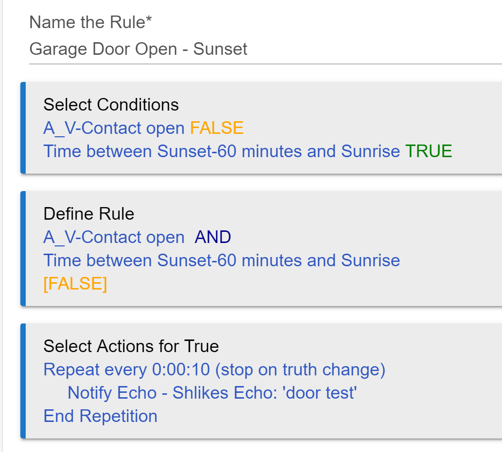

At message 119, @dan.t suggested the repeat was needed prior to the notice and the end repeat after. Well this never ends even after the contact was closed
It repeats like clockwork until I paused the rule
Edit: Here is another log which show an error which I think might be related to the constant repeat.
Edit: It almost seems like once the contact is open, it just keep looping through the actions and never reconsiders the state of the trigger. Is it necessary to also put the trigger in the IF statement to ensure it is considered on each pass through?
Edit: Nope that didn't work, still repeating until I pause the rule. I even put in an Else before the End repeating and notice in the log above, it is skipping the else and the end repeating
Edit: This works just fine in RM 3
Rick
Part of the problem is that you are using "open" as a trigger, thus closing it doesn't cause the rule to be re-evaluated.
The proper trigger would be "changed"
The actions need to be if xx open then repeat "whatever" (with stop option selected)
else stop repeat actions
This doesn't guarantee the errors go away, but at least you won't have the continuous repeats.
