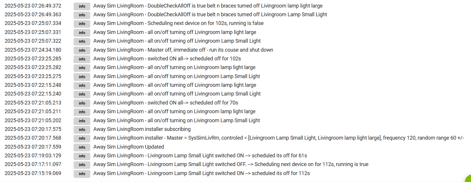

Updated logic and Dimmer control capability

Updated as requested
  1. descriptions updated
  2. Either one light will be randomly selected from the list and operated or all lights will be operated per cycle
  3. either one random or all toggle added
