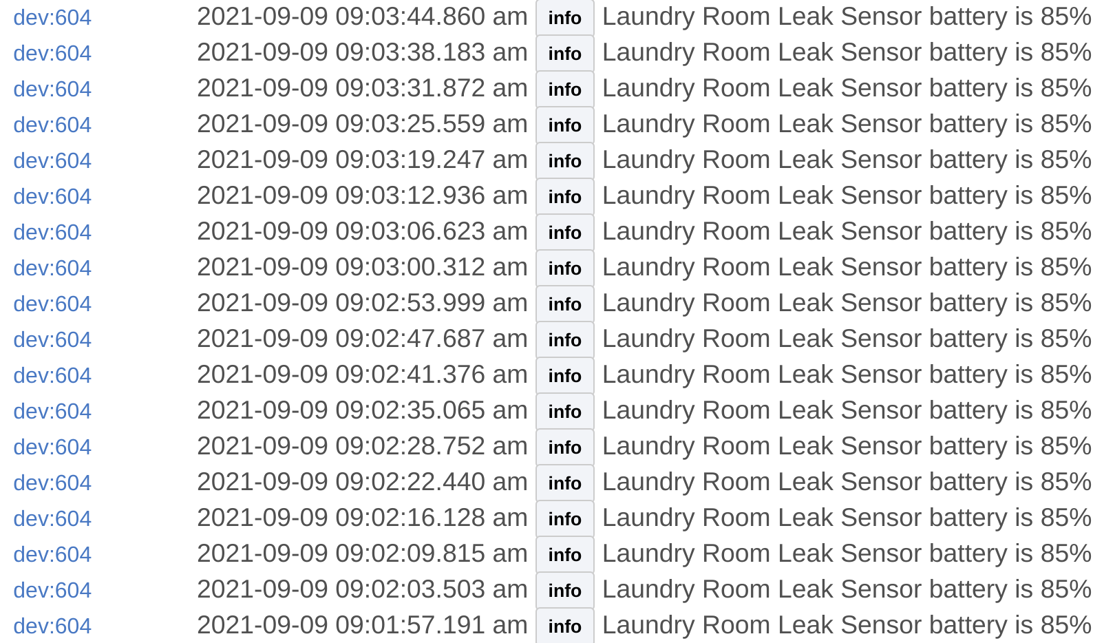

Hey, look what I got this morning... 7s reporting - after working fine since pairing. Stopped on its own after ~50 minutes.
@agnes.zooz I hope tech support is able to figure out what is going on with these devices and/or prove it is a hub issue. Although even if it were a hub issue - something like the hub not sending an ACK - I still don't think the device should spam the mesh with reports for that long.
What started the reporting? Was there water detected, did it start after its 12 hour wakeup/check-in, or was it just random? For me... at least as far as I've noticed, it's never random. Only after an event.
Hard to tell.
We're trying to replicate this to see how we can possible address the issue. Random occurrences are the most challenging to troubleshoot but we're definitely looking into it. I'll keep you posted if we're able to find the root cause here.
This jives with one of the things Zooz support wrote back to me recently.
The sensor would only try sending the report multiple times if the hub didn't confirm receipt of the information.
I don't really have a way of knowing what the hub is doing other than looking at the logs. I'm hoping they work better with the 2.2.9 release.
Yes, but even then.... I alqways thought the device should not try to send messages "forever", even if not receiving an ACK from the hub. It should try a few times, try a different route a few times - then stop. But it is a complicated topic, and there are different message machnisms, so I could be wrong as I'm making a few assumptions on what the device is actually doing.
Eventually someone will get some sniffer logs while this is happening, which is what the Zooz devs really need to understand what is happening at a message level.
