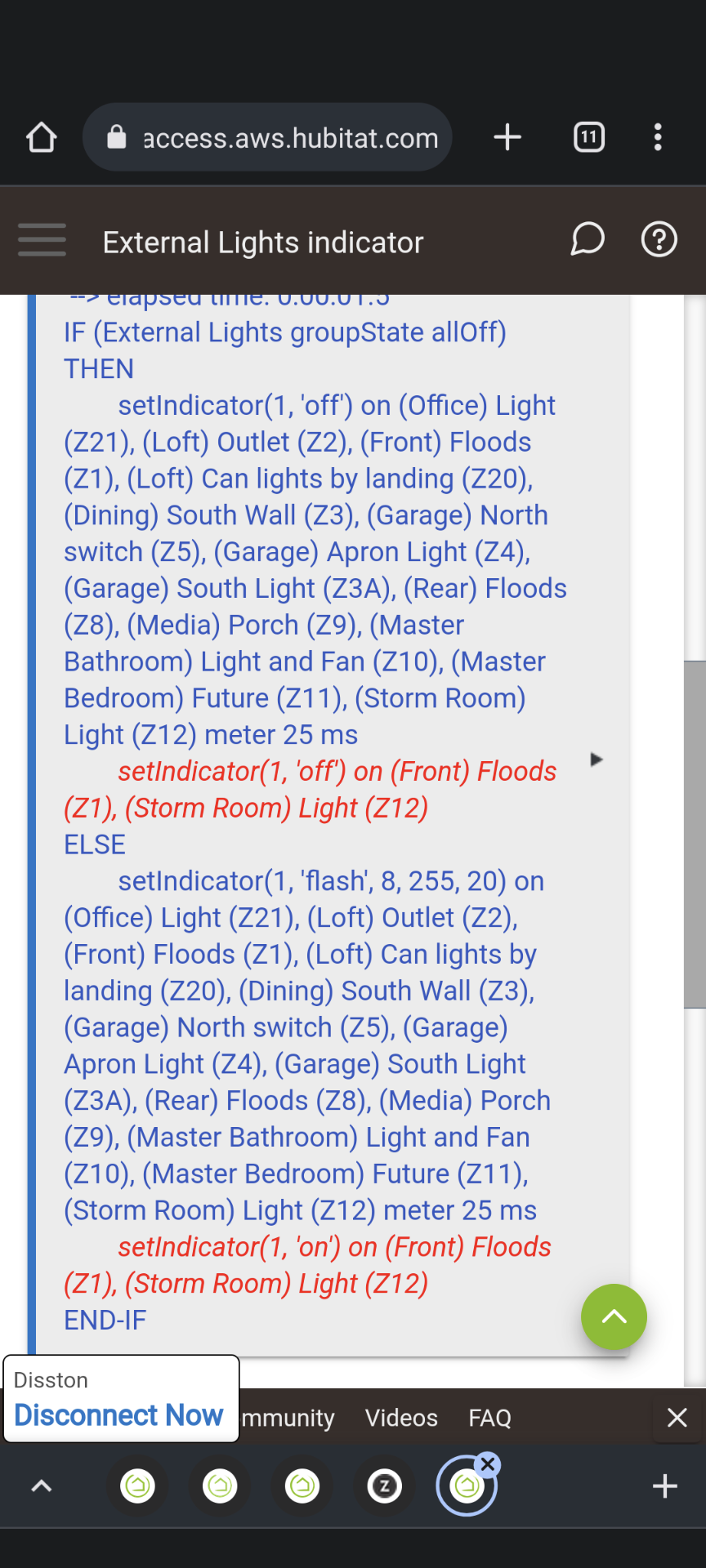

I'd start by posting the rule here and checking Logs for errors.
Looos OK to me. Next I'd enable debug logging in the driver and see what it does (action logging for the rule wouldn't hurt either--could also be something there since it works from the device detail page for you).

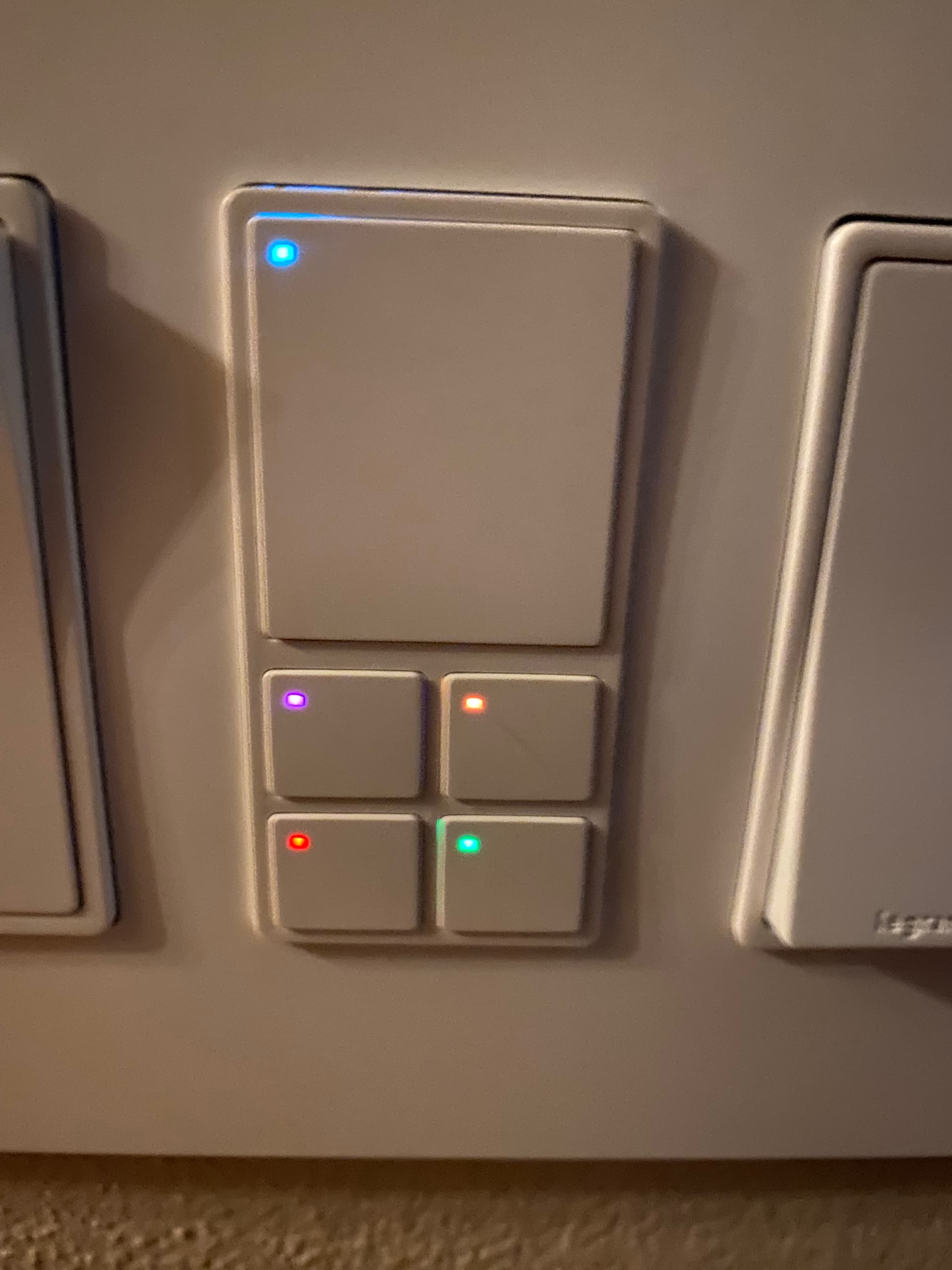

New to Zen32 here. Love it so far.
I can see above in the thread where folks are talking about the extra LED blinks upon a button push. I too would like to avoid/eliminate them as I’m using LED brightness and color to indicate various settings in my home at-a-glance. These extraneous blinks just create visual “noise”.
What I can’t tell is whether anyone has found a way to avoid these blinks. Any pointers?

I just received the 800LR version a week or so ago. One thing to note as of now it appears the firmware for that hardware isn’t working with the Indicator class. I have let their support know this. This means that you can’t turn a LED indicator on, off, or flash with this driver using the setIndicator() methods. You can still turn them on and off using the parameters however. Hopefully this will be corrected in a future firmware version.
I heard back from support and they indicated that this fix is scheduled for sometime in October.
Pardon the ignorance here, but I'm trying to interpret the parms listed here. I've been playing with them in order to eliminate the extraneous LED flashes and can't quite figure it out..
My use-case: I'm only using them as scene controllers (no connected loads) and no 3-ways. They are used as (1) a switch, turning scenes on and off physically from the wall, and (2) to control room-specific "automation overrides" that activate (when held) or deactivate (double-tap) motion lighting and other automations.
My translation of the above for configuring the device driver =
- set parm #19 to enable physical and zwave
- I want no flashing (because LED brightness and color are used in my setup to indicate states), so I have #23 to disabled.
- I have parm #24 set to Enabled
- and I have "Relay LED Indicator Model" from @jtp10181's fork set to 'Control with "Set LED" command'
- #20, #21. #26 do not apply, and I have #22 disabled.
- Since I'm not using Associations (yet), I have #25 set to None.
Anybody see a problem? And why would I still get interim LED flashes given that #23 is disabled?
When watching the log, I notice that the driver will produce 2-5 repeated events -- e.g., "Scene Controller LED #5 set to Red" or "....set to On" milliseconds apart.
Appreciate any ideas!
