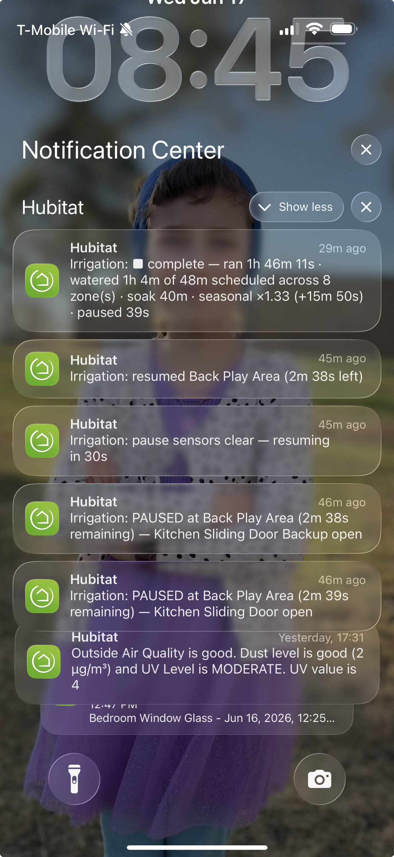

- Pause & resume (my favorite feature) — point any contact or switch at it and an in-progress run pauses mid-zone and then resumes from exactly where it left off when the trigger clears. It remembers the remaining seconds for the current zone — it does not restart the zone or the whole schedule. Perfect for a back-door/gate contact (kids and pets don't get blasted), a "guests are over" override switch, etc., with a configurable resume delay and an option to fully stop instead of pause.
- Safety — quiet hours, mode/HSM restrictions, pump/master-valve control, a software per-zone max-run cap, and the hardware Auto-Off failsafe described above. The hardware push now verifies the timers actually landed on the device instead of just claiming success.
- Control & visibility — exposes each zone (and a "Run schedule now") as a child switch for HomeKit / dashboards / Rule Machine, granular templated notifications (incl. Pushover), run history, a next-7-days preview, an iCalendar feed, a JSON API, and backup/restore.
