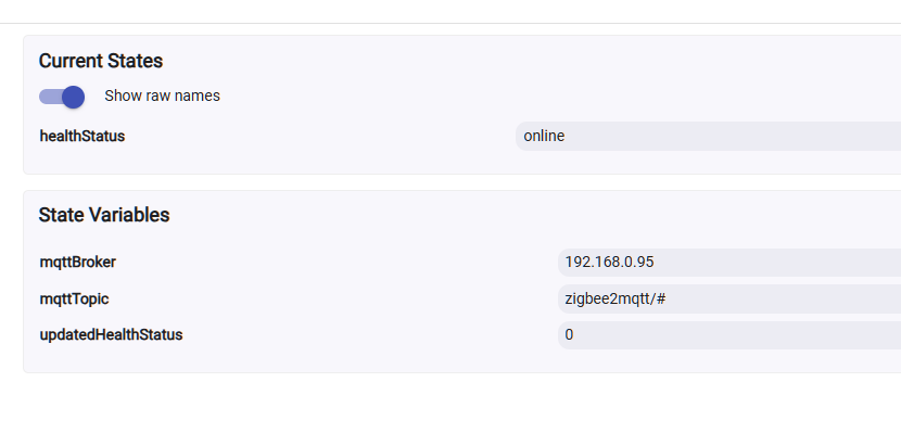

I used HPM and the Z2M rotuing driver wasn't instaIled, I did it manually, but getting unauthorized. I do not have security for my mqtt broker on HA
dev:22902025-08-21 09:47:40.774 AM
error
___Z2M : mqttConnect : Not authorized to connect
dev:22902025-08-21 09:47:31.606 AM
trace
___Z2M : Trace Logging : false
dev:22902025-08-21 09:47:31.605 AM
debug
___Z2M : Debug Logging : false
dev:22902025-08-21 09:47:31.572 AM
info
___Z2M : Info Logging : true
dev:22902025-08-21 09:47:31.570 AM
info
___Z2M : Preferences updated.
