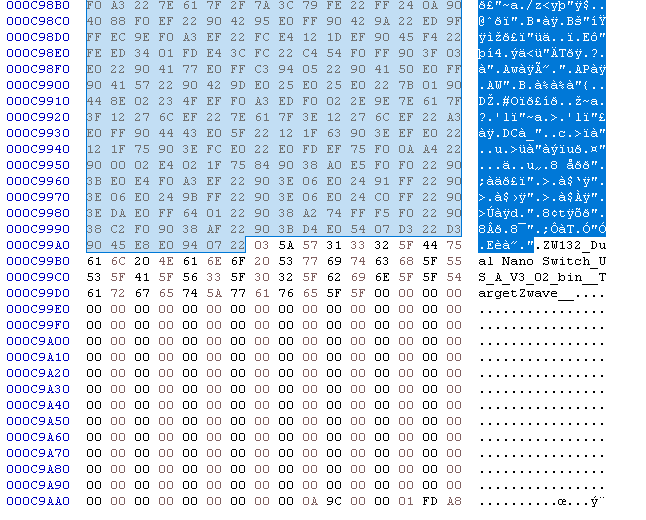

Tried to update an Aeotec ZW132-A (US version of dual nano switch with energy reading).
Extracted firmware using instructions above from exe in zip file linked here: (ZW132) Dual Nano Switch with energy reading V3.02 firmware update. : Aeotec Help Desk
Used built-in firmware updated in C7 hardware, and got Device Firmware Updater ERROR: The device was unable to receive the requested firmware data without checksum error.
Not sure if I got the wrong part of the firmware from the file, or if it's because I have the device included in non secure mode.

Ok, so I probably just extracted the firmware incorrectly. Any good tips on this? I followed the instructions earlier in the thread, bit don't know how to verify without just sending it to the device.

Ok - tried a few times to extract and update firmware from here: https://aeotec.freshdesk.com/helpdesk/attachments/6120512642
The examples above all have the firmware filename starting on a new line - where do I cut off in this case?:

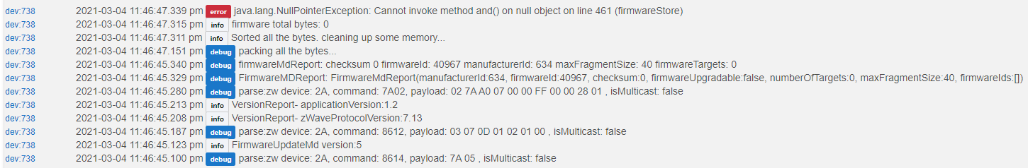

I tried upgrading to all 3 versions, but after it transfers the firmware to the device, I always get a Device Firmware Updater: ERROR: Insufficient memory error message, and the device is not upgraded.
Do you know why this is?
I'm trying to upgrade 2 Aeotec Nano Shutter (US version) from firmware 2.02 to any of those 3 versions I shared above. Both of them fail in the same way. I'm using the built-in "Device Firmware Updater" app.
Looking at the logs, I see messages like this:
FirmwareMdReport(manufacturerId:134, firmwareId:909, checksum:33533, firmwareUpgradable:false, numberOfTargets:0, maxFragmentSize:20, firmwareIds:[], hardwareVersion:null)
Any ideas on how to troubleshoot/workaround this "insufficient memory" error?

Hi - I've tried using HxD to extract but I got a checksum error loading the firmware to the device after getting to 100%.
Anyone able to extract the firmware for me from this?
