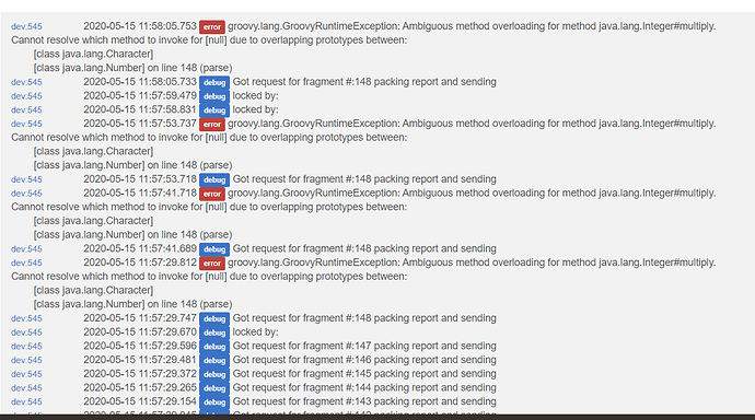

@bcopeland:
I hit abort process during fragment uploading (because I wanted to turn off debug logging), and got the following:
The errors kept coming until i pulled the airgap on the dimmer (Inovelli Red series).
Everything is fine after the power cycle.
Yep.. Abort is quite a destructive process.. You could have disabled debug logging without hitting abort..
The errors you were seeing is because the device was still requesting fragments that the driver no longer had in memory
I figured as much, but wanted to report it just in case.
That is good to know about being able to update the logging during the process.
I guess you could add an if (abort) there to ignore the request and avoid the error message, but the device has to be power cycled anyways it looks like, so it is likely a moot point.
