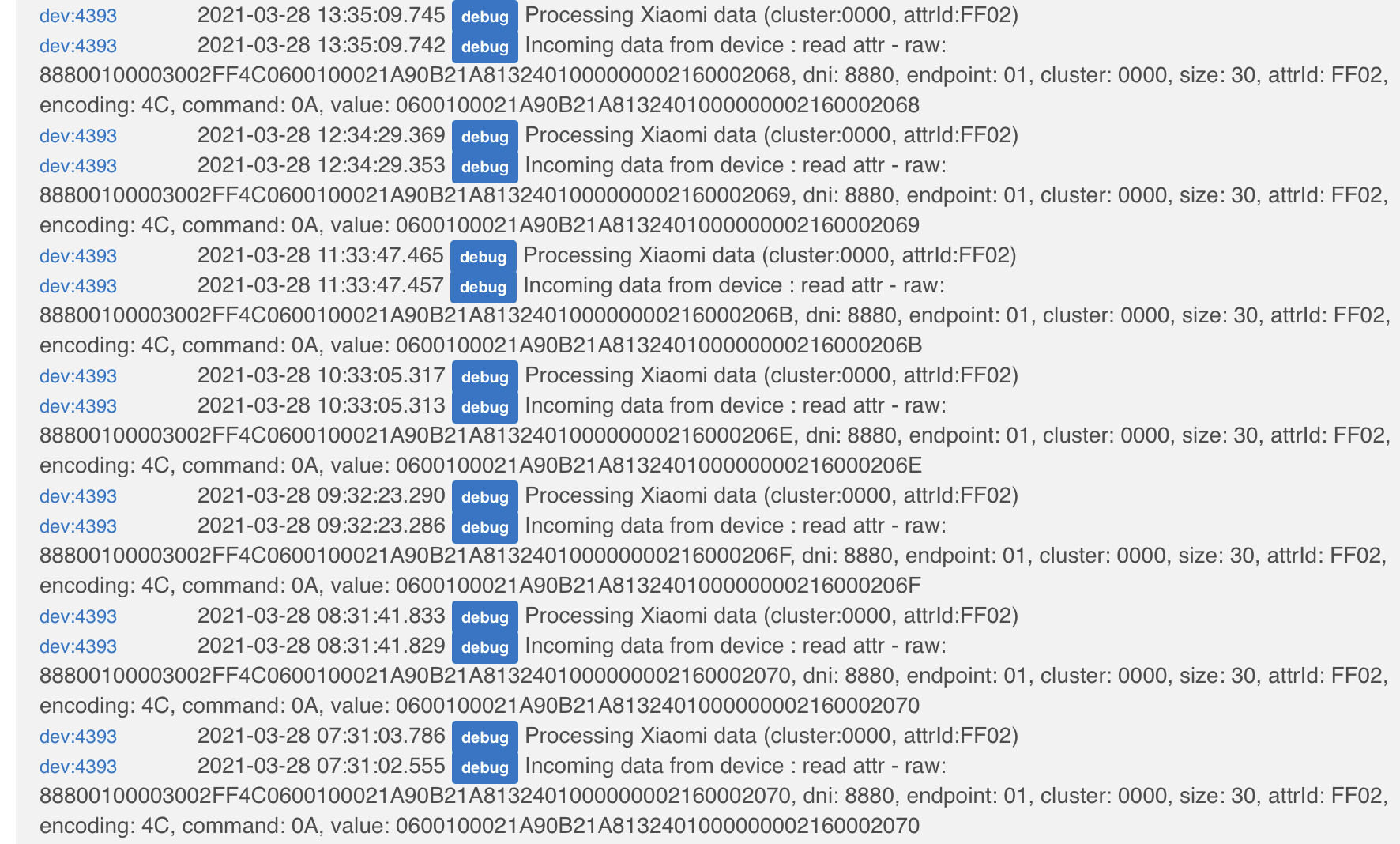

Seeing some debug logs with debut logging disabled. I had a quick look at the code, but cannot find any apparent cause... Though I am not a developer, so what would be apparent to some is not to me.
Is there a way to disable these?
Driver version:
Xiaomi Aqara Mijia Sensors and Switches v0.13
Hhmmm. That's strange.
I'm using this driver for a few devices and I'm not seeing this.
Maybe try enabling, refresh/configure, then disable and refresh/configure for device 4393.
Great idea! Will give that a try. Will also enable/save and disable/save logging in case it makes a difference.
Let me know if hitting it with a hammer works or not :wink:
Lol. The sensor or the hub? :rofl:
Well, I haven’t seen any more logging since, so I will conclude that your solution worked! Thanks again!
Try to hit configure on those devices.
That is most likely a leftover scheduled job from a different driver. Doing as @igor.lehotan says should resolve it.
