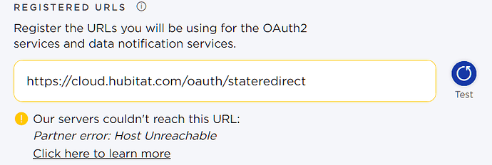

So how do I install your app?
I attempted to follow an instruction but for the REGISTERED URL I am getting this:
Do the install via hubitat package manager. If you're sure all parts are installed, go into the driver and make sure oauth is enabled. HPM should automatically enable it and make sure the full package is installed.
I am all set. Thank you very much.
