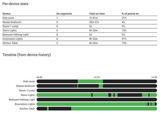

:bar_chart: Perfect your simulations with Analyzer
The Analyzer is an optional child app you can add alongside simulators.
For now, it’s focused and simple:
• Analyze lighting history for a date range
• Visualize overlaps and idle gaps
• Learn how your house actually behaves
[Example Analysis of a weekend Light use]

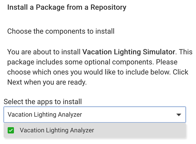

Recommended: Install via Hubitat Package Manager (HPM) :star:
The easiest (and safest) way to install is using
Hubitat Package Manager.
With HPM you get:
• Automatic installation of Parent + Child apps
• Clean upgrades when new versions are released
• Less copy/paste, more happiness
How to install with HPM:
• Open HPM
• Choose Install
• Search for Vacation Lighting Simulator
• Follow the prompts
That’s it — HPM handles the rest.
[Screenshot]
(:camera_flash: Selecting the optional + Analyzer child)

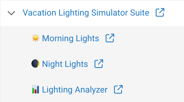

After installation
• Go to Apps → Add User App
• Select Vacation Lighting Manager
• Add one or more Simulator children
• Optionally add the Analyzer child
Each Simulator child can represent a different “behavior pattern”
(morning, evening, weekend, etc.).

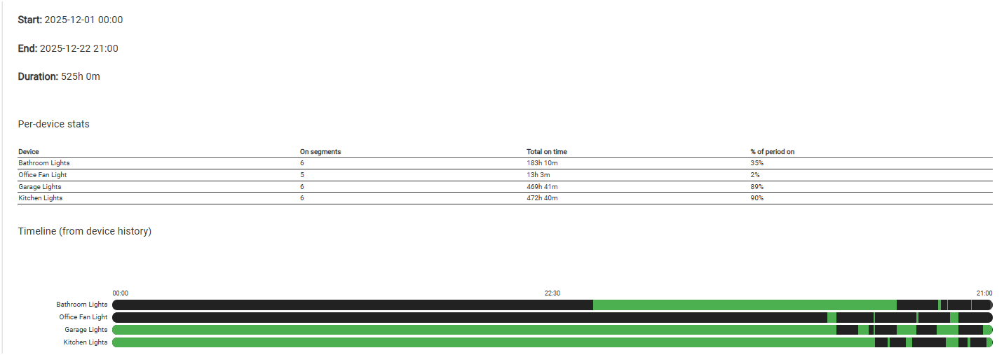

Very cool. I gave the analyzer a try. This isn't even close to being correct, but how does it know when any given light is on or off for any arbitrary time period?
Hey, thank you for trying it out!
Thank your for reporting, so for the second part, it specifically looks at the last 1,000 events from the device that Hubitat stores.
device.currentValue("switch")
device.eventsSince(time)
Do you know which part? The table should be correct based on what Habitat has stored (last 1,000 vents). But to your point your kitchen being on almost 24 hours would be odd. Can you try a smaller slice of time?
Edit: I wonder if the 1,000 events limit are causing an on/off to be dropped or not seen, so things seem on longer than true.
Also, the graph over the time period isn't really useful as everything is so compressed. It's really meant to look over a 48/24 hour or so time-line. Beyond that you can't really see any events.
Edit 2: I also might have found a bug for longer ranges, I'm working on now. But honestly this shouldn't be used longer than a week, and that is probably the upper bound. I might need to cap it at that.
I just picked December to date for the graph, no particular reason why.
There's no way the kitchen lights for example were on 90% of the time. They go on at sunset and generally remain on at some level until around midnight, give or take a few hours, unless we're not home. The garage lights are generally on longer as I'm in and out of the garage all day and usually leave the lights on.
Every one except for the office fan light would have at the very least one on segment per day, so at least 22 for December to date.
Does the hub really store that many events per device?
Update: The Kitchen Lights, for example, has 3 events going back as far as 11/28 but then there's a 14-day gap until the next event on 12/12.
Or readjust the starting point of the graph to the earliest event that exists. Might get a little messy with multiple devices though that have different ranges of events.
But yeah, I'm not sure there's a real need to see an entire month's worth of data. Most people's lighting patterns are probably discernable in a much shorter time period.
Super helpful, I also am realizing the 'level' might be throwing it off. I see some lights the "switch" doesn't change if the levels are set for on/off. This should work fine with the vacation mode as I specifically set on/off not level. But for general analysis it might not work... let me see.
You're probably right. The vast majority of my switches are Inovelli 2-in-1's. The events for the kitchen lights for example only include off() and setLevel(1), there's no on() events at all.
Oh wild. Just 1? I was about to push an update that is looking at level > 5, as I know some lights and some people's automation set level just above 0 for off. But I can adjust to >0 if not.
Edit: OK, I pushed an update (0.3.1) that will ask you to reselect the lights you want to track, I'm looking at on/off and level being set above >5 as on, below as off. What I can't fix is if the events of a device are not present. So think is probably better used for validating the visualizing the simulation runs to ensure you are happy.
Yes. Hue bulbs and downlights dim all the way down to level 1 without flickering. They emit just enough light to softly illuminate a room so you can walk around without walking into things. A good number of them come on at sunset at level 1.
I think that's rarely the case for normal dumb led bulbs though. The few that I have won't do anything until level is around 10-15.

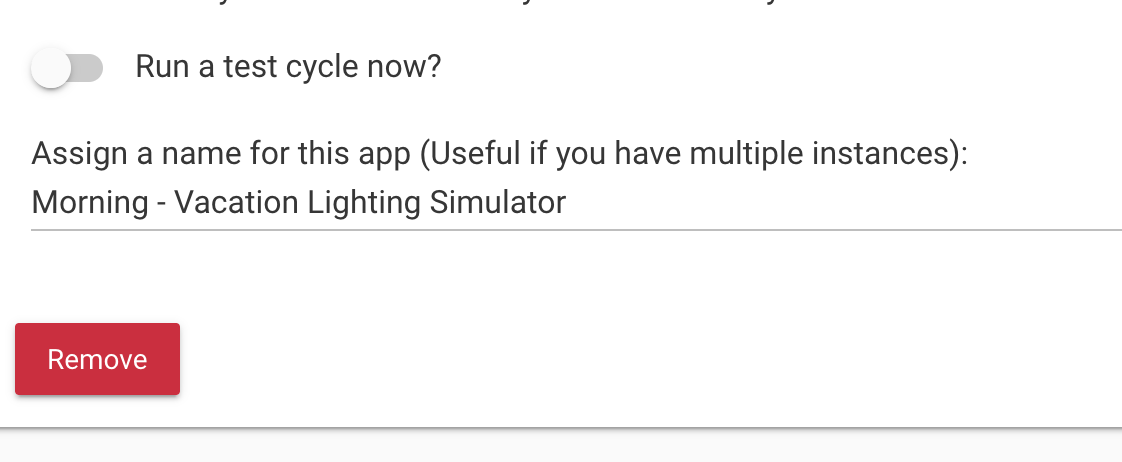

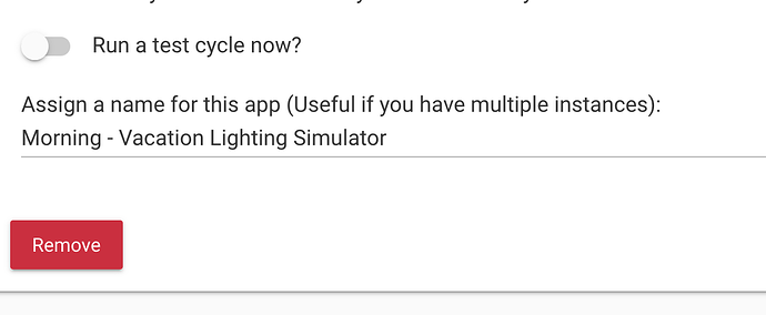

I just by mistake added another child schedule. When I was about to remove it The message asked remove vacation lighting simulator, just want to be sure Only that child will be removed and not the whole app before I do.
Yes, when you remove from within the child page, it will only remove the child:
To your point, the message is a big confusing, but I can't control the text, that is hubitat using the parent app name even though only the child is being removed.
