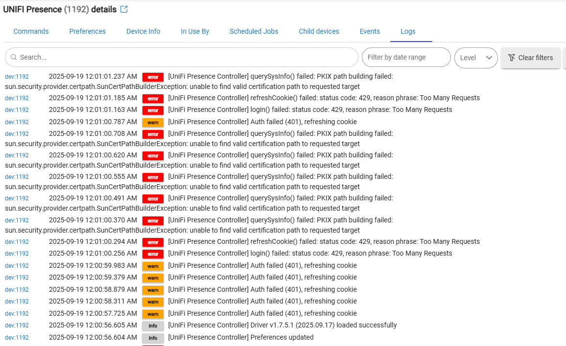

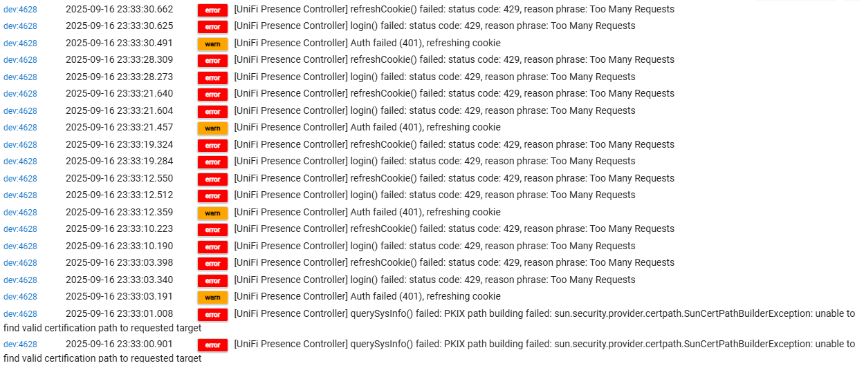

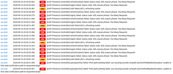

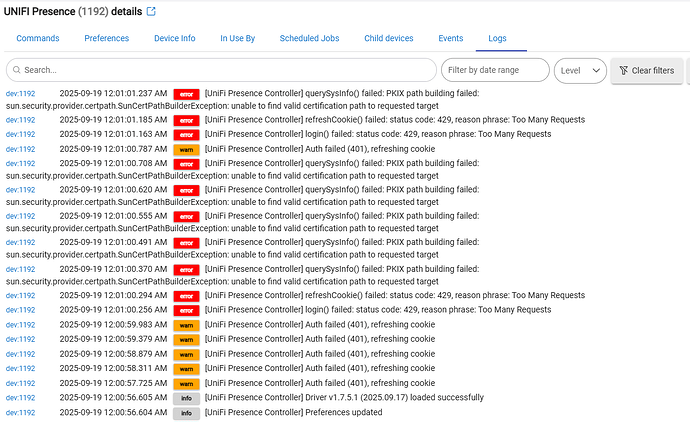

I created the new local account, no success:
I feel like I missing something, but I don't know what!
Local admin account worked for me. I was seeing the same error in the logs as you. What I ended up doing was
  1. In the UniFi Controller, deleted the local account I made
  2. Create a new local admin account
  3. Log into UniFi controller with the account to make sure the credentials work
  4. Go the UniFi Controller device in HE and update the credential
I found that I did could set the username in UniFi to whatever I want (for example, "hubitat"), and that username goes into the username field in the Preferences tab in HE. It doesn't seem like I needed to match the local admin's username password to the UniFi owner account.
Correct, those are precisely the troubleshooting steps I'd take. :wink:
The local admin account is completely separate from your regular account and can be named anything you want.
@userLP24. Are you able to login with the credentials you created manually? Also, double-check the details on the preferences tab.

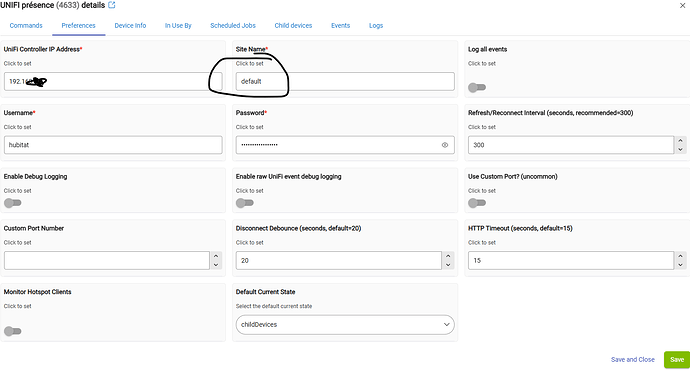

What did you enter for the site name setting? I entered the name of my device (which contains a space) and I got all sorts of errors, including the ones shown in your screenshot.
I didn't read closely enough, but when I changed the site name to "default" everything started working.
@MHedish You probably should remove the required flag for site name and just default to "default" if it's blank. Also, you should url encode whatever is in site name or else it throws another error, like this:
httpExecWithAuthCheck() general error: Illegal character in path at index 49: https://10.0.7.1:443/proxy/network/api/s/Wildwood House/stat/sysinfo
I'll put the URL encoding on the revision list. That'll cover the issue with the space in your device name.

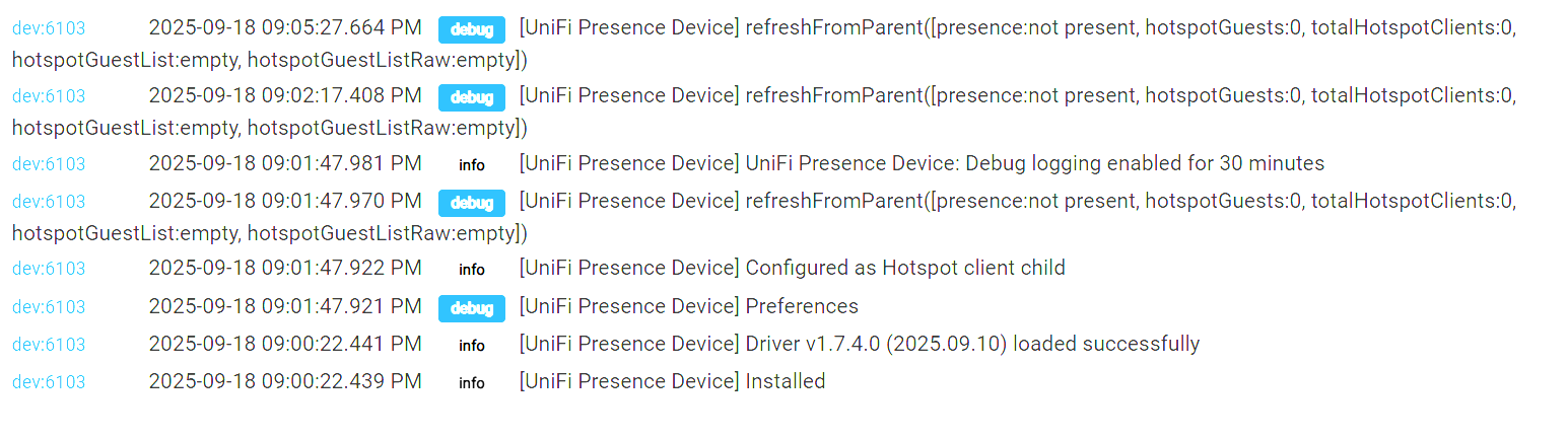

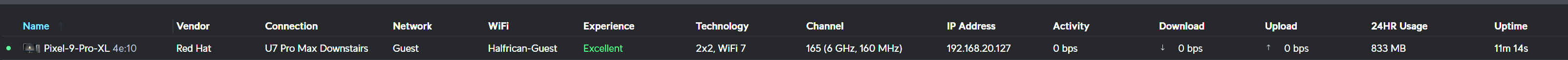

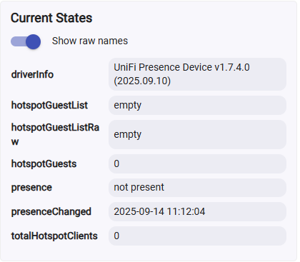

I enabled the feature to monitor guest hotspot monitoring. Tried connecting to my guest WiFi but my device is not being picked up by the driver. It does show as connected in my Unifi controller. Is there a specific configuration for the hotspot zone that needs to be set for this to work?
Not at all. As long as hotspot monitoring is enabled, the driver checks for the number of devices currently connected as well as the number of guests that are unexpired but not connected.
In my case, "Guest" is the rollup childDevice and guestDevices enumerates the count.

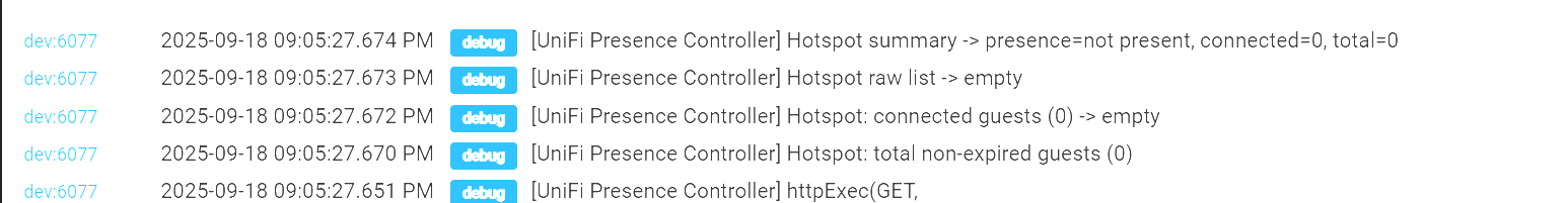

Turn on debug logging and let me know if you see any errors.

I don't see any errors with debug logging enabled, however, devices connected to my guest network are not populating at all.
