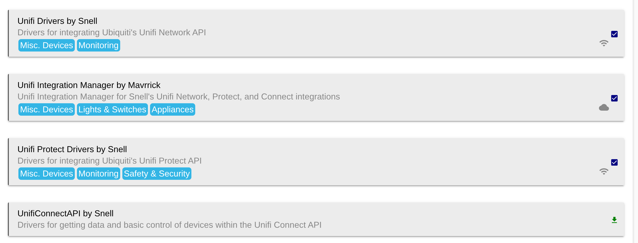

How do you get it
All of the integrations are available through HPM. Simply open up HPM search for Unifi and install all of the components you want to use. The @snell's Unifi driver packs and the Unifi Integration Manager are currently all grouped together as shown below.
If you don't have all of the Unifi apps in your Unifi environment you don't have to install them.
Once all of the driver packs you need are installed from HPM on your hub, you can install the Unifi Integration Manager app in the Hubitat UI.

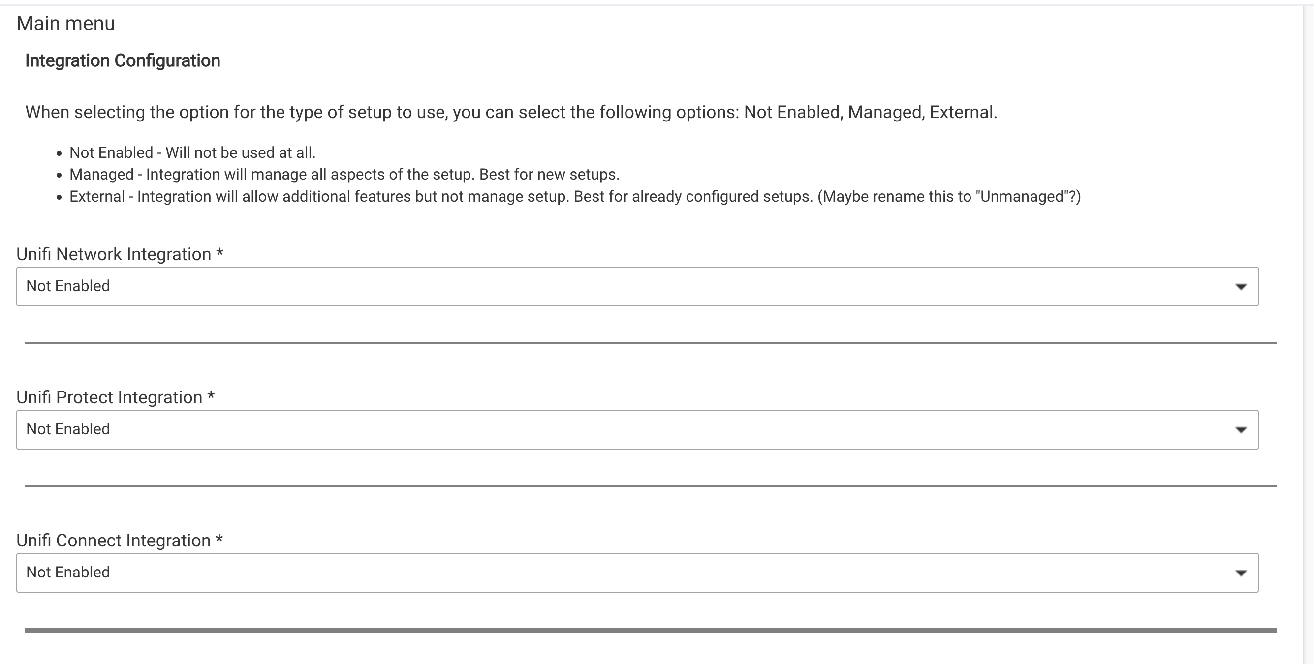

Upon starting the install of the application you will be greeted with a page that looks like this.
By default all integrations are set to not enabled. Select the integrations you want to activate and change to Managed, or External. As shown in the top of the above screen shot a Managed selection will allow full control from the app, and would be preferred for a new install. Once that selection is made you will be presented with new options that allow you to specify additional setup parms like the type of Unifi controller use, User I'd, Password, Refresh Rate, and if you want child devices for your Unifi gear to be created, ect.

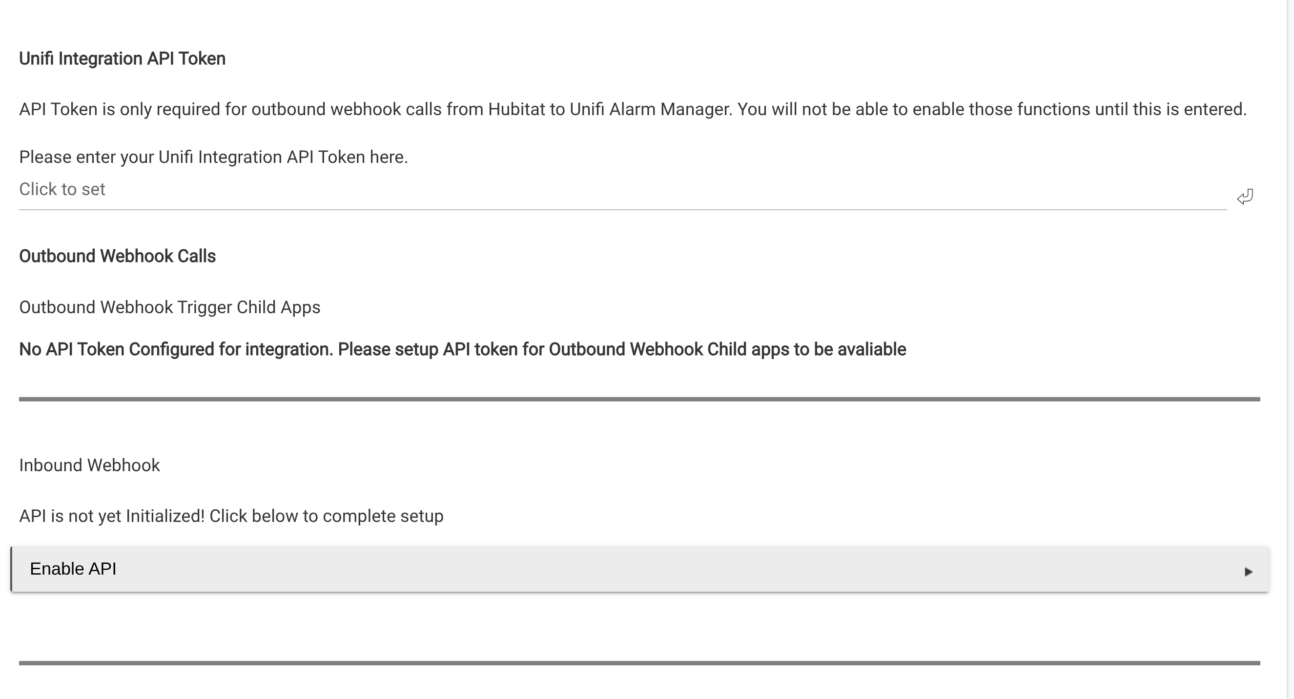

Once all of the configuration for the integration is done you can then setup your inbound and outbound API Webhook configurations. Scroll down a little bit passed the integration configuration options and you should be able to see some information like below.
To enable configuration for outbound Webhook calls from Hubitat to Unifi obtain the Token from your Unifi Environment and enter it on the available line for your token. Once entered pres "tab" on your keyboard and you will now have a option to configured Outbound Webhook Child apps.
Below that you also have the ability to click a button and enable Inbound webhooks from Unifi Alarm Manager to Hubitat.

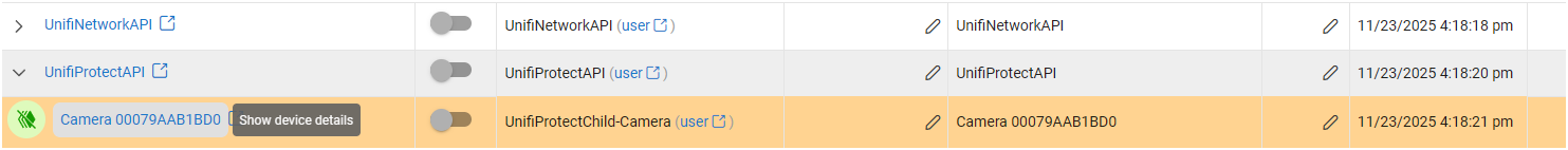

I am having trouble getting this set up. I have an existing instalation of Unifi Protect by @Snell.
When i select the "Choose Device" it just shows a blank line.
I tried removing all the protect devices and the app, and then selecting managed. It created the Protect Device and a Child camers, but no Doorbell device,
Also what is ment by "Please select the controller type Protect *" which just had a dropdown showing various time settings?

You are correct, i was using the built in intigration.
I just reinstalled and chose managed
It installed the unifi protect and a camera child device. I guess this is my doorbell camera??
It shows as a third party camera, and i do have several 3rd party cameras set up in Protect.

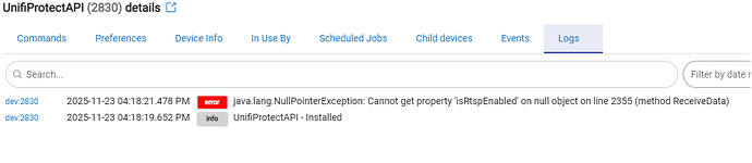

I posted an update to my side of this (my Unifi Protect API drivers) that should clean up the isRtspEnabled error.
