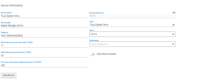

Tengo una de estas TS0601_IRRIGATION_VALVE.
No consigo que funcione con el controlador de ninguna manera. Puedo estar haciendo algo mal?
Hi @apelayo1986 ,
I will need more details about your device.
As an example, see the information in this post :
Please provide screenshots of the Zigbee model/manufacturer and screenshots of the Current States and State Variables.

You have a mix of Marcus's drivers and this one ...
  1. Delete (REMOVE) the device from the HE web page red button.
  2. Pair it again to the hub.
Now, when you have the correct driver installed, the valve should be automatically recognized as 'S0601_GIEX_VALVE'
However, I see in the statistics from the screenshots that there are only four Zigbee messages received, and that the result of the Ping() command is 'timeout'.
This usually means Zigbee connectivity problems with the Hubitat C-8 hub ...
Anyway, try removing the valve from HE and pairing it once again. This driver should be automatically selected, if the pairing succeeds.
Then, click on the Ping() command button - you should see the rtt (Round-Trip time) numeric value in milliseconds. If the Ping() command results in a 'timeout' after 10 seconds - this will be bad news..
