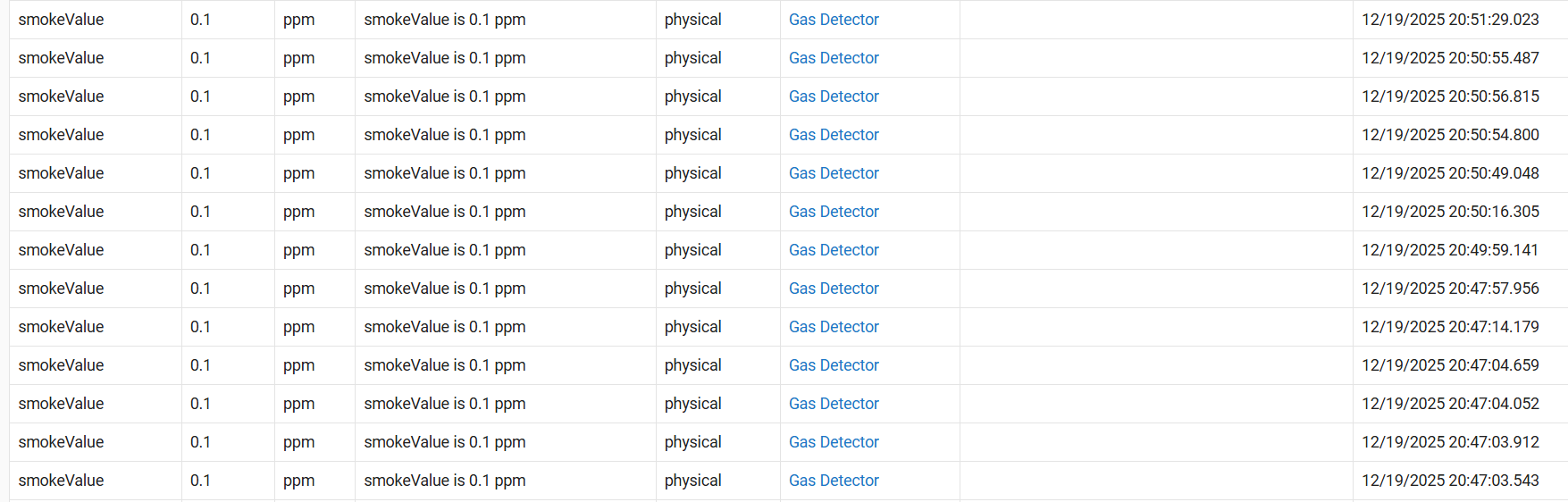

@kkossev I've got a couple of _TZE200_yvx5lh6k devices. Not sure how feasible these are to add. They're very chatty in their current state, I'm noticing.
Here's what they log as a generic device.
[dev:477](http://10.0.0.103/logs#)2024-06-11 11:55:12.959[info](http://10.0.0.103/logs#)Zigbee parsed:[raw:catchall: 0104 EF00 01 01 0040 00 7984 01 00 0000 02 01 000102020004000002C0, profileId:0104, clusterId:EF00, clusterInt:61184, sourceEndpoint:01, destinationEndpoint:01, options:0040, messageType:00, dni:7984, isClusterSpecific:true, isManufacturerSpecific:false, manufacturerId:0000, command:02, direction:01, data:[00, 01, 02, 02, 00, 04, 00, 00, 02, C0]]
[dev:477](http://10.0.0.103/logs#)2024-06-11 11:55:12.910[info](http://10.0.0.103/logs#)Zigbee parsed:[raw:catchall: 0104 EF00 01 01 0040 00 7984 01 00 0000 02 01 00011502000400000011, profileId:0104, clusterId:EF00, clusterInt:61184, sourceEndpoint:01, destinationEndpoint:01, options:0040, messageType:00, dni:7984, isClusterSpecific:true, isManufacturerSpecific:false, manufacturerId:0000, command:02, direction:01, data:[00, 01, 15, 02, 00, 04, 00, 00, 00, 11]]
[dev:477](http://10.0.0.103/logs#)2024-06-11 11:55:12.872[info](http://10.0.0.103/logs#)Zigbee parsed:[raw:catchall: 0104 EF00 01 01 0040 00 7984 01 00 0000 02 01 00011602000400000009, profileId:0104, clusterId:EF00, clusterInt:61184, sourceEndpoint:01, destinationEndpoint:01, options:0040, messageType:00, dni:7984, isClusterSpecific:true, isManufacturerSpecific:false, manufacturerId:0000, command:02, direction:01, data:[00, 01, 16, 02, 00, 04, 00, 00, 00, 09]]
[dev:477](http://10.0.0.103/logs#)2024-06-11 11:55:11.618[info](http://10.0.0.103/logs#)Zigbee parsed:[raw:catchall: 0104 EF00 01 01 0040 00 7984 01 00 0000 02 01 0000130200040000041A, profileId:0104, clusterId:EF00, clusterInt:61184, sourceEndpoint:01, destinationEndpoint:01, options:0040, messageType:00, dni:7984, isClusterSpecific:true, isManufacturerSpecific:false, manufacturerId:0000, command:02, direction:01, data:[00, 00, 13, 02, 00, 04, 00, 00, 04, 1A]]
[dev:477](http://10.0.0.103/logs#)2024-06-11 11:55:11.577[info](http://10.0.0.103/logs#)Zigbee parsed:[raw:catchall: 0104 EF00 01 01 0040 00 7984 01 00 0000 02 01 0000120200040000010A, profileId:0104, clusterId:EF00, clusterInt:61184, sourceEndpoint:01, destinationEndpoint:01, options:0040, messageType:00, dni:7984, isClusterSpecific:true, isManufacturerSpecific:false, manufacturerId:0000, command:02, direction:01, data:[00, 00, 12, 02, 00, 04, 00, 00, 01, 0A]]
[dev:477](http://10.0.0.103/logs#)2024-06-11 11:55:11.193[info](http://10.0.0.103/logs#)fingerprint profileId:"0104", endpointId:"01", inClusters:"0004,0005,EF00,0000", outClusters:"0019,000A", model:"TS0601", manufacturer:"_TZE200_yvx5lh6k", controllerType: "ZGB"
[dev:477](http://10.0.0.103/logs#)2024-06-11 11:55:11.114[trace](http://10.0.0.103/logs#)ZCL version:03
[dev:477](http://10.0.0.103/logs#)2024-06-11 11:55:11.103[trace](http://10.0.0.103/logs#)Software Build Id:unknown
[dev:477](http://10.0.0.103/logs#)2024-06-11 11:55:11.099[trace](http://10.0.0.103/logs#)Model:TS0601
[dev:477](http://10.0.0.103/logs#)2024-06-11 11:55:11.089[trace](http://10.0.0.103/logs#)Manufacturer:_TZE200_yvx5lh6k
[dev:477](http://10.0.0.103/logs#)2024-06-11 11:55:10.998[debug](http://10.0.0.103/logs#)getting info for unknown Zigbee device...
@adamkempenich - this is not a smoke detector, but a device to test how robust your Zigbee network is! I have one similar spammer that I keep locked in a driver and I turn it on occasionaly for a few minutes only for stress-tesing my Zigbee network!
Seriously, my recommendation is to not use this device. It is 5 times more spammy than the spammiest Tuya mmWave sensor.
Wow -- they were sold as smoke detectors. Even come in a smoke detector shroud. Explains why they're using that cluster.
I'd already removed it again from my network after posting that info, but appreciate the heads up.
The real smoke detectors are just the opposite - very quiet...
Check with the seller, they may have sent you a wrong device, or there was a mistake when placing the purchase order.
DO NOT BUY!
