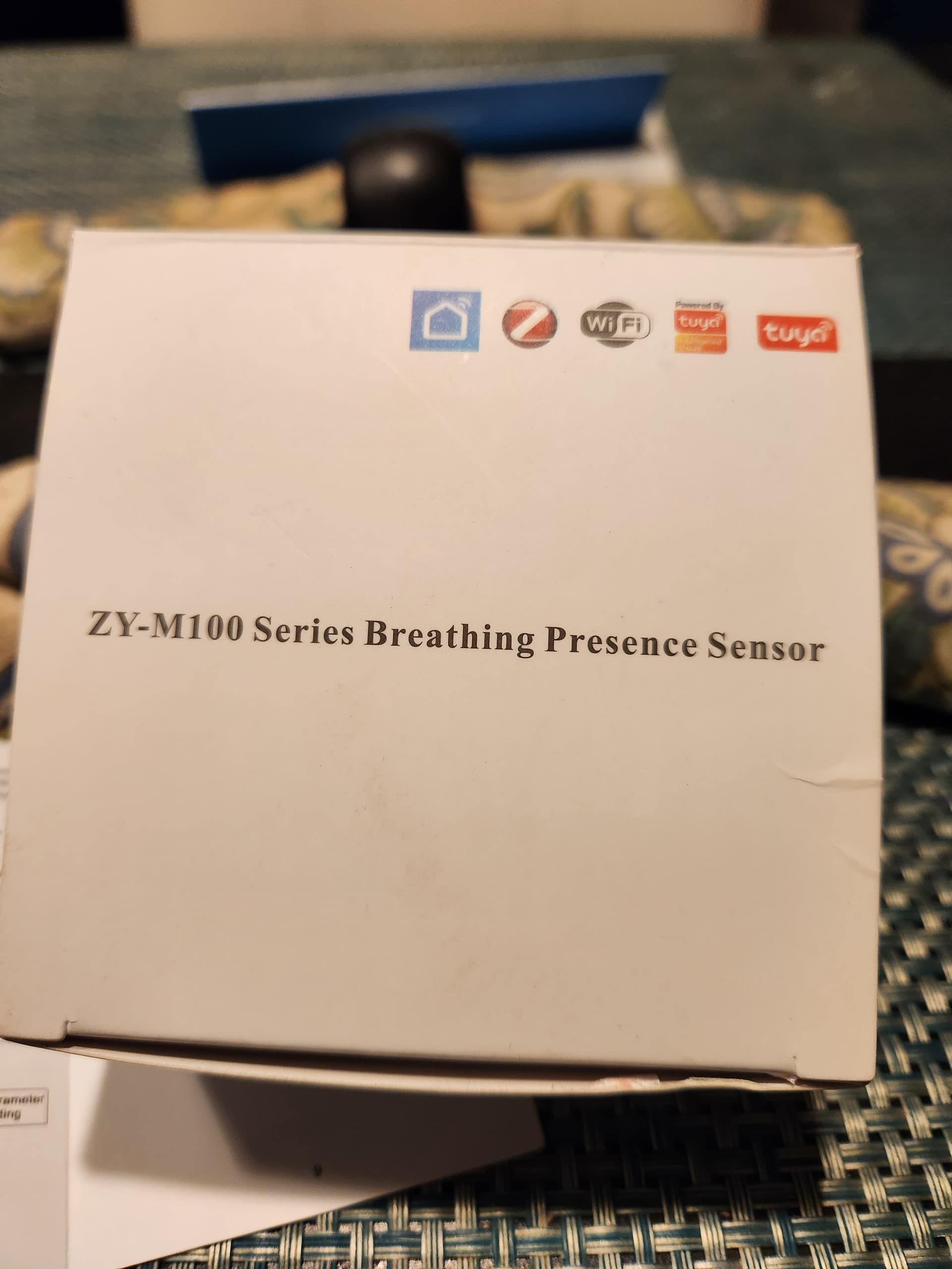

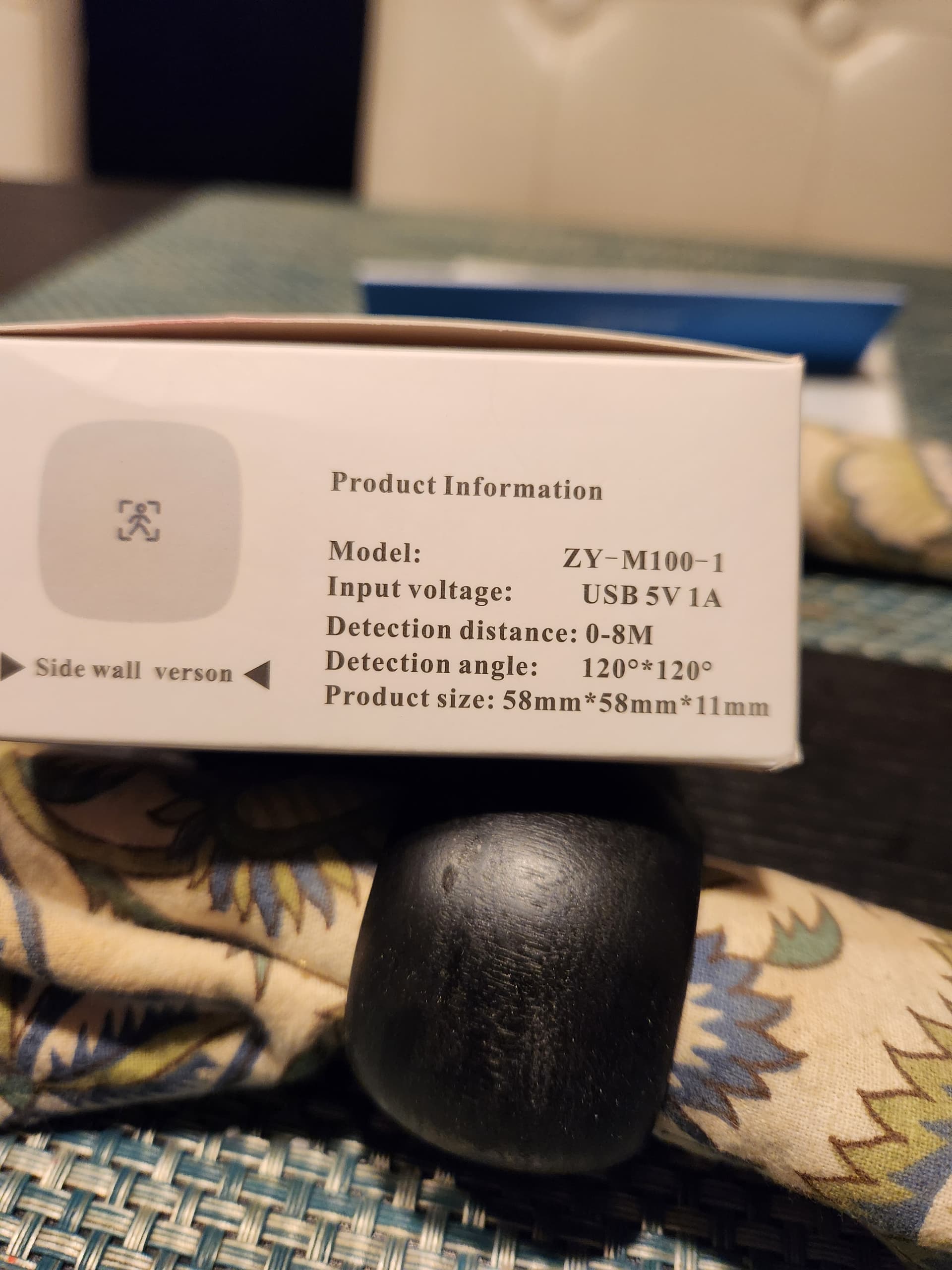

The box says ZY-M100-1. Attached is a pic of the box. Bought on Amazon and advertized as Zigbee.
Thanks for your help.
It is hard to say anything looking at the boxes... You see the inconsistency - both Zigbe and WiFi logos (this is not possible!), ZY-M100 on the top of the box, but 'ZY-Z-WALL-US' label on the side, etc...
Typically, Tuya-based mmWave sensors labeled ZY-M100 are among the most spammy devices. These are produced by more than a dozen different manufacturers and then sold by at least two dozens of different branded 'trading companies'.
My advice will be to return it, and look for another model from another seller.

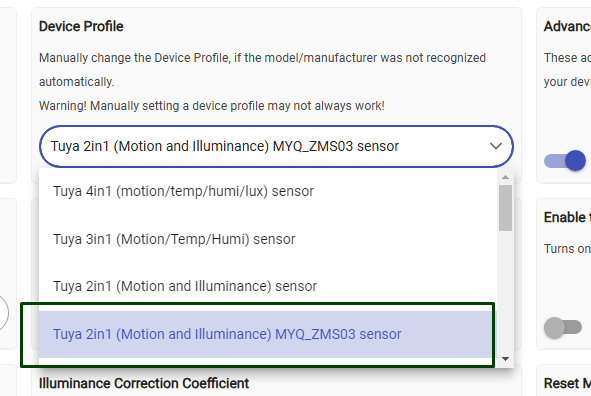

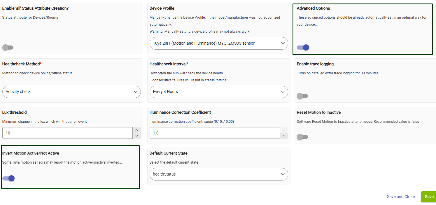

Can you try changing the 'device profile' manually to 'Tuya 2in1 (Motion and Illuminance) MYQ_ZMS03 sensor' ?
Thank you for the fast response. Amazing! I am still learning Hubitat. Yes, I tried the MYQ driver you referenced. With that driver it seems to stay inactive even with me waving my hand and/or walking in front of it. If I put it in a drawer and close it so it is dark it will change to active and stay there until i take it out. Then it will revert back to inactive and stay there despite movement.
I have tried all of the drivers to some degree or another, and get a variance of the same issue. It seems to react to light and no light. I have played around a little with the lux threshold but I don't know what I am doing.
You may need to join the Hubitat owners group on this community so you can post images. Then, please try posting your screenshots again.
Do you see this deviceProfile in the Commands tab?
Update: I have uploaded a new version 3.3.3, where TS0601 _TZE200_ppuj1vem was moved to 'TS0601_2IN1_MYQ_ZMS03' deviceProfile.
Now also, you can invert the motion active/inactive state :
Let me know if this makes a difference.
After updating the drier, click on the 'Configure' Run button - your device should be automatically recognized and configured with (hopefully the correct default settnings.

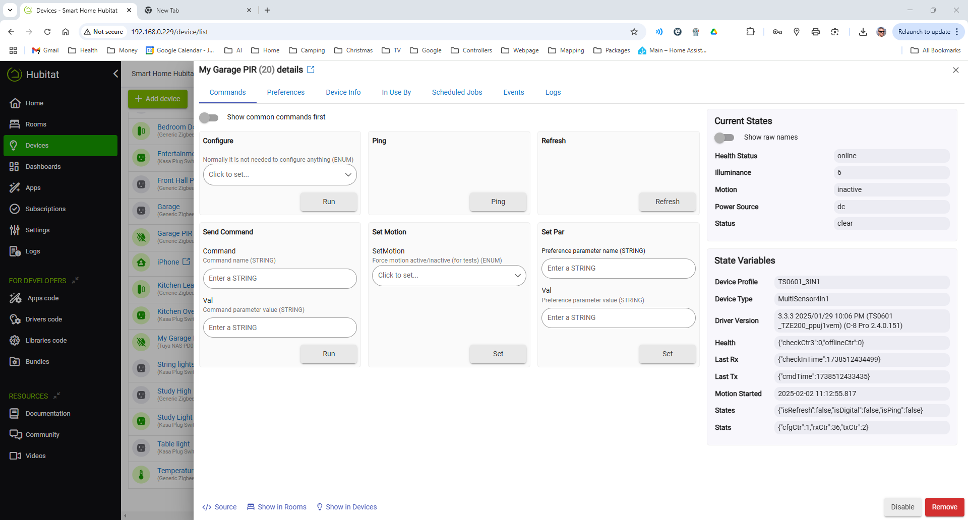

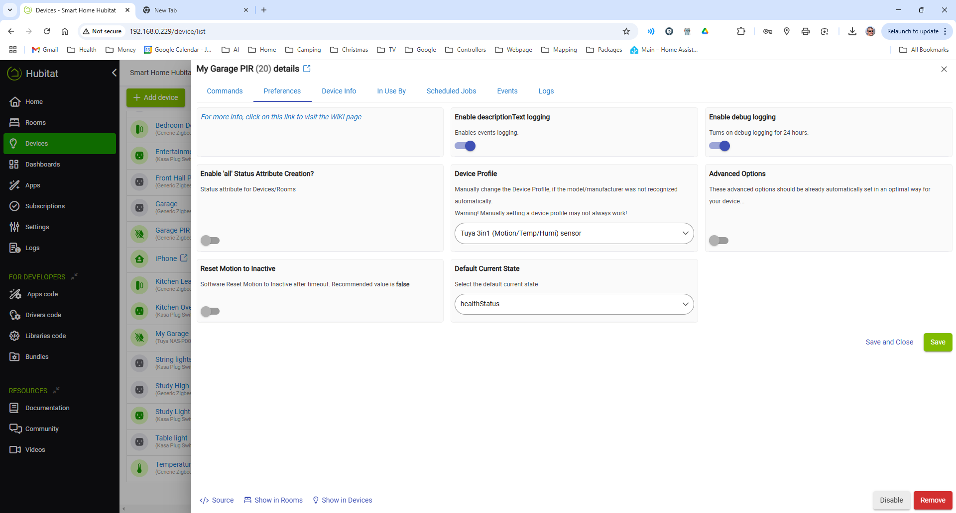

I joined the Hubitat Owners group so I hope you cans see the attachments now. I updated to the 3.3.3 and Loaded All Defaults.
Here are the State Variables if you can't see the attachment.
Device Profile TS0601_2IN1_MYQ_ZMS03
Device Type MultiSensor4in1
Driver Version 3.3.1 2024/10/26 12:47 PM (TS0601 _TZE200_ppuj1vem) (C-8 Pro 2.4.0.151)
Health {"checkCtr3":0,"offlineCtr":0}
Last Rx {"checkInTime":1738444624452,"illumTime":1738444787388}
Last Tx {"cmdTime":1738444621319}
Motion Started 2025-02-01 16:21:02.393
States {"isRefresh":false,"isDigital":false,"isPing":false}
Stats {"cfgCtr":3,"rxCtr":10,"txCtr":6,"illumCtr":3}
It is pretty much staying inactive.

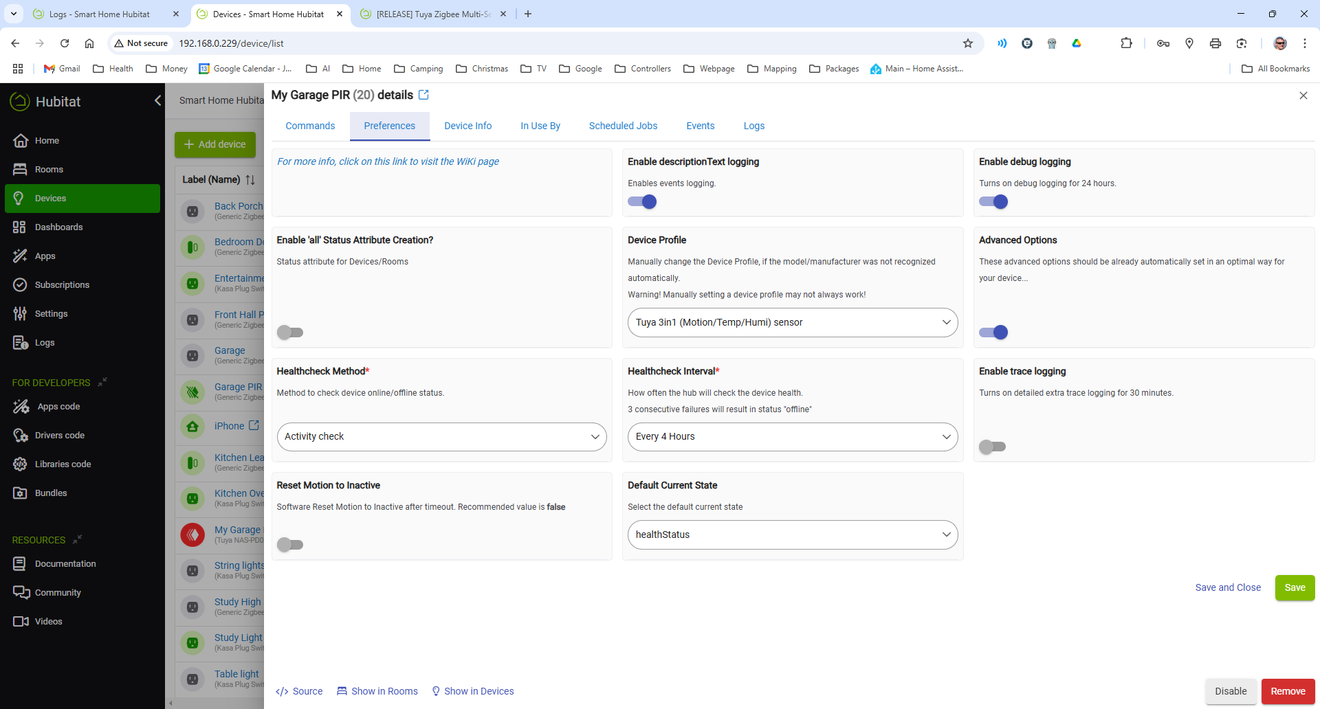

Well I guess I did not have it updated all the way to 3.3.3. I updated again and it has the device profile of TS0601_3in1 and the Device type is Mulisensor4in1. It is now showing motion correctly. Thanks!
