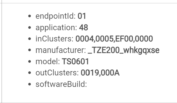

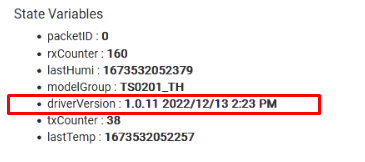

No humidity events show up on the device events page. I am able to breath onto the sensor and raise the temperature and humidity quickly. Here are the logs.
Summary
