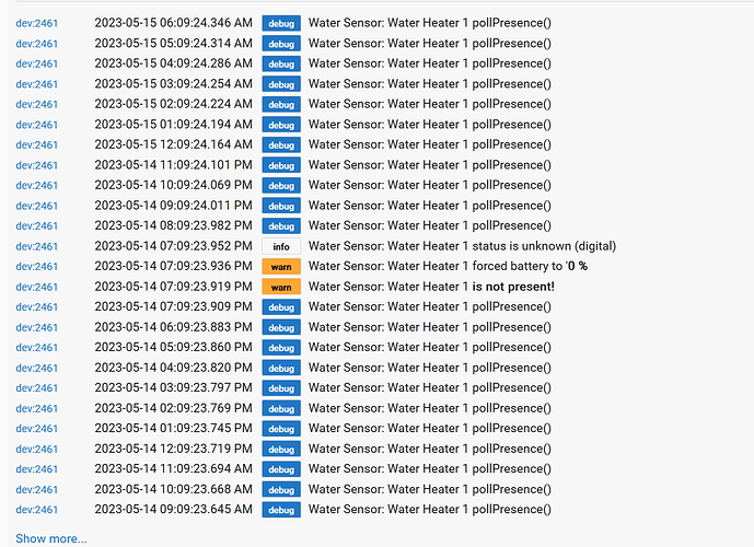

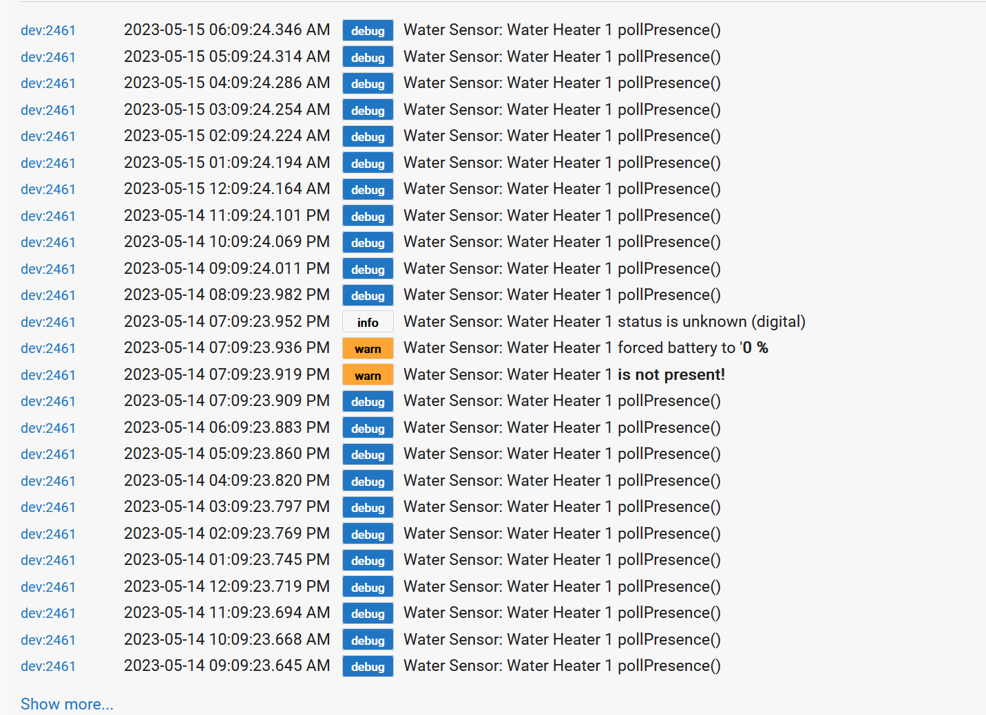

Current logs
There are no battery level reports, seems like the device has dropped off the Zigbee mesh.

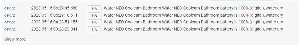

Mine is reporting the battery every 1 hour :
EDIT: these are not actually battery reports, but time synchronization requests from the Tuya device.
(digital) in the logs means, that the battery report was not physically sent by the device, but generated digitally from the driver (based on the last battery report actually received), and the purpose of this workaround is to keep the 'LastActivityAt' device property updated with the last time something was received from the sensor. This means that the device is alive and paired to the hub.

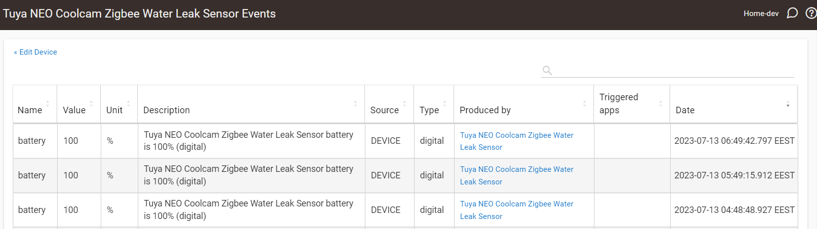

Don't you have battery level events of a type 'digital' every hour?
Like this :

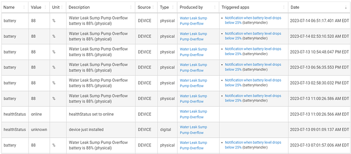

I have several reporting type=physical every 4 hours. Battery values vary, one is 100%. I will press the button and see if type changes to digital. I have one I had to rejoin recently, it is reporting hourly and type=digital.
No, I do not. This physical battery event posts every 4 hours or so.
This is with your Tuya NEO Coolcam Zigbee Water Leak Sensor, but in looking into it, I may have a down-level (1.0.7). I'll upgrade to 1.1.1 to see what happens. I do use HPM, but somehow missed intervening revisions.
I only have 100% reports currently, but in the past I have gotten low battery reports leading to me changing the batteries on the sensor. I don't remember if I got gradually lower battery reports or if the reporting just dropped from 100% to a low level suddenly.

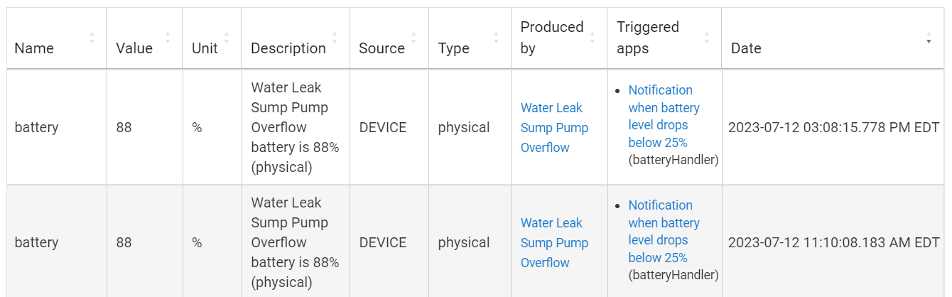

After updating to driver to 1.1.1, the battery events I'm getting are still showing as Physical and still at 88.

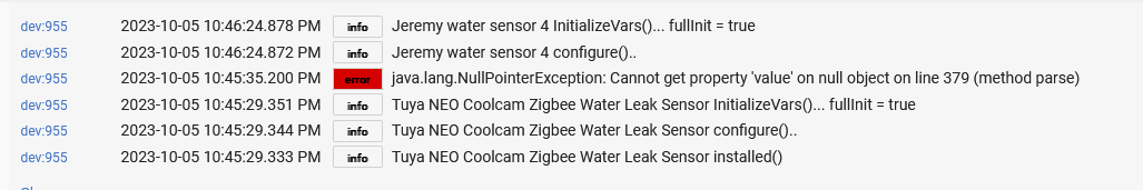

also once when it didnt pair I got the following error message (not really concerned since they eventually paired but just in case it helps at all
