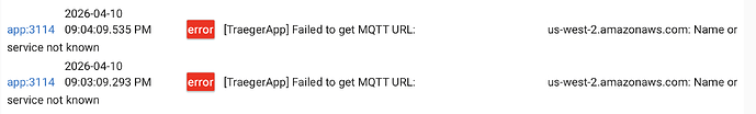

Not sure what is going on, but my logs were filled up with messages from the integration when I checked them today. My grill is currently offline. Here are the messages, repeated constantly. For now, I've uninstalled the app/driver.
Sorry the image of the logs is so small. I'm having some trouble with my image editing app.

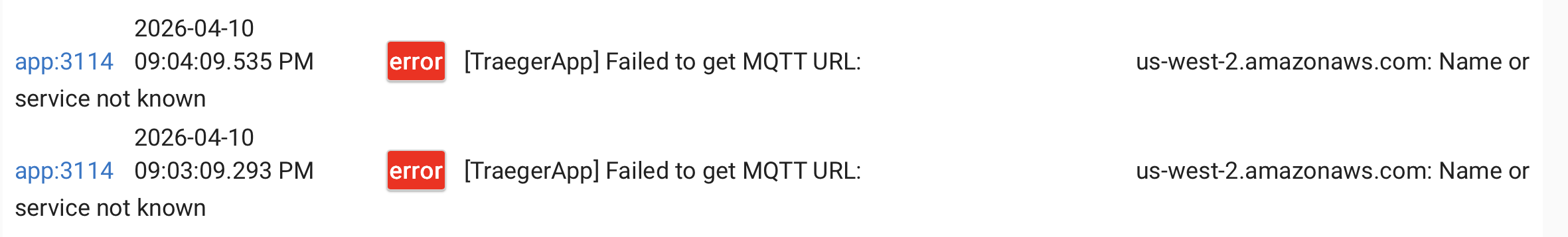

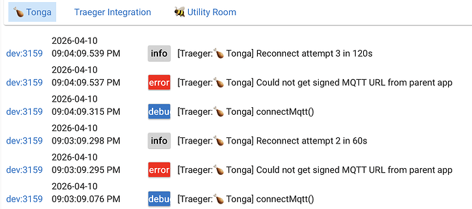

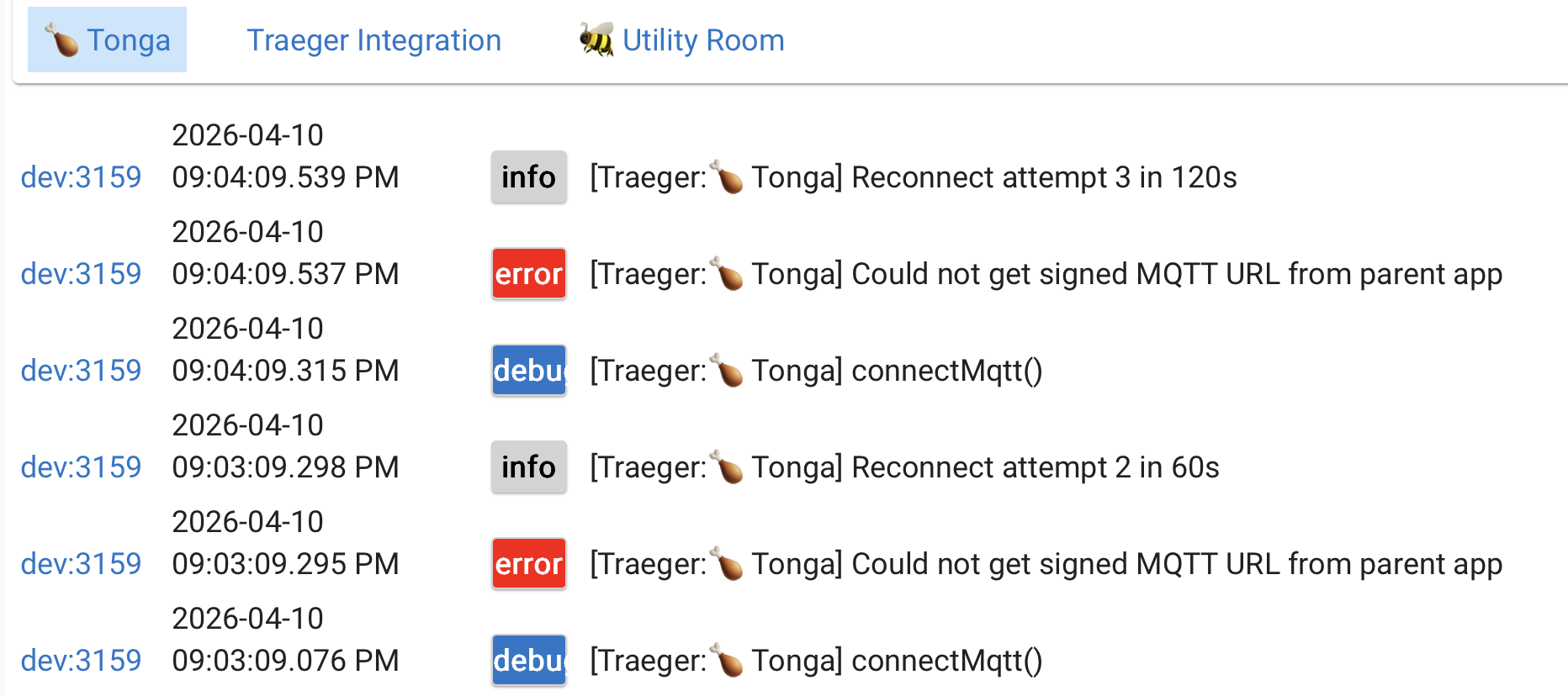

So I have two Traegers at different locations. When I first set this up, it worked at both locations. Now, one works, but the other doesn't. Here are the logs on the non working one. I deleted the beginning of the URL as not sure if it is private.
Suggestions?

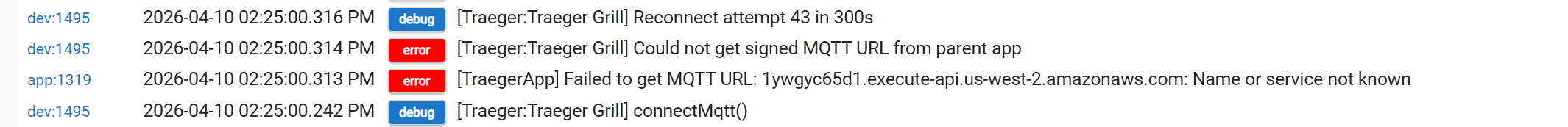

By chance is the grill you can no longer talk to offline, i.e. powered off? I've been working with @craigde on a problem with errors being thrown when my grill is offline. He fixed one bug, but I started seeing errors again yesterday every time it tries to reconnect:
Yes, it shows offline. It is plugged in and powered on, but waiting to be awoken. Traeger app shows both sleeping.
Okay, that's a slightly different case than mine. My grill is powered off. I would expect that if your grill is powered, even if sleeping, that it would be communicating.
Update:
I just fired up my grill to do a cook. Still seeing the same error. Traeger app seems to be fine.
Update 2:
I just went nuclear and deleted the app and driver. Installed the app for a fresh start and I'm seeing the same errors when I try to discover devices. Something seems to have changed on the Amazon end.
