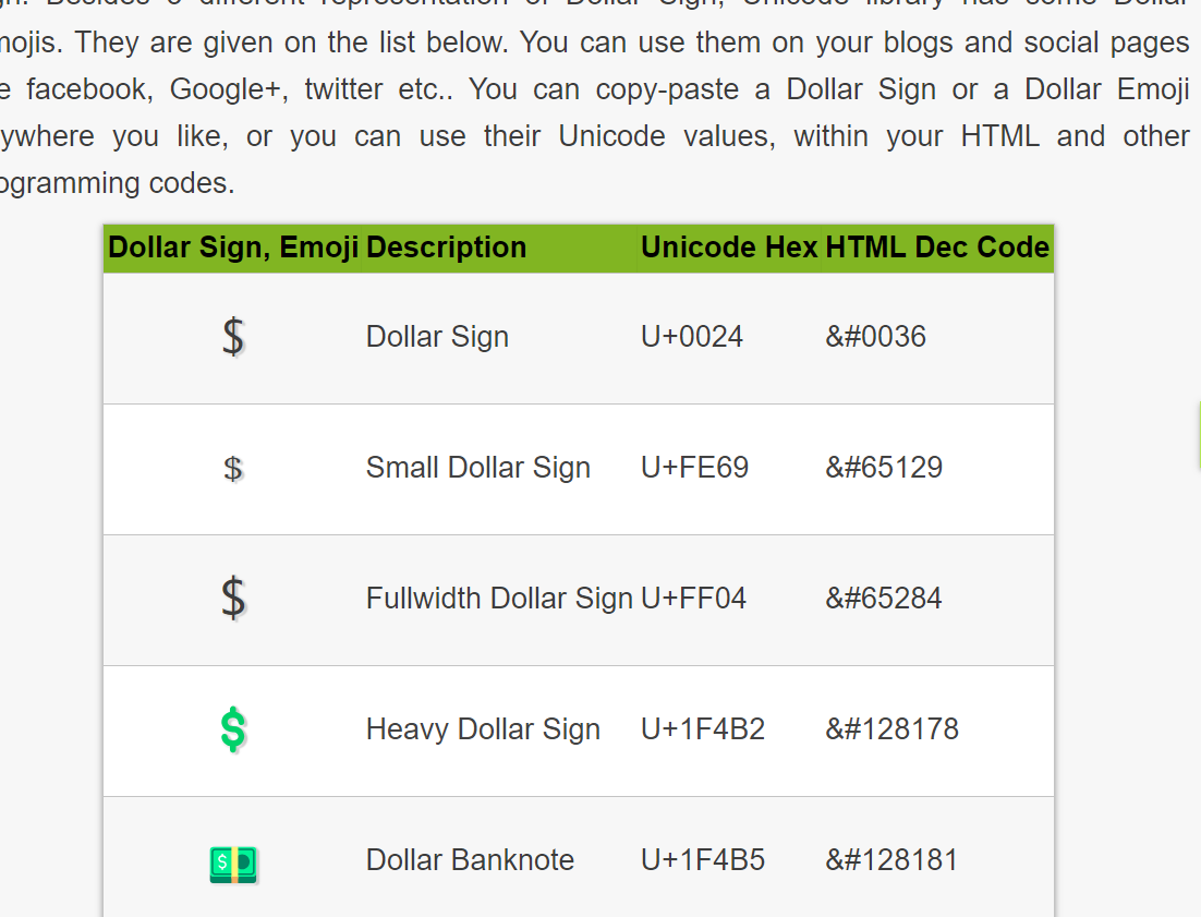

@garyjmilne quick question. I've found that putting the $ character in the prepend or append field of a multi attribute for a device causes this error. After generating that error I can't get get back to the multi attribute child to edit after getting this error. Any thoughts other than for me to remember not to use certain characters in those prepend and append fields?
There are some characters in groovy that have a special meaning. I make mention of these in the built-in help but it's under an advanced section where you can enter text as you can with prepend and append, but that section is not visible to you. I need to update the code to make sure those special characters are stripped from the prepend\append field to prevent the crash you are experiencing.
The presence of any of these cause groovy to interpret the string differently. In the case of the $ sign it tells groovy that whatever follows the $ sign is the name of a variable.
To get around this you will find that there are multiple versions of many common symbols. In the case of the dollar symbol it's only the first one that has special purpose so you can use any of the other 3 in it's place.
