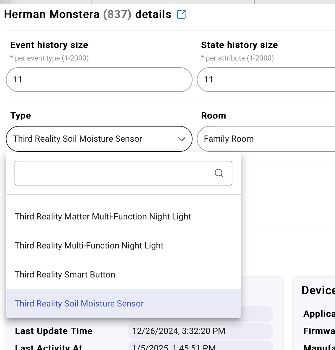

Built in driver? Is this on the beta program, I don't see the 3real soil sensor listed
Built-in & working well thus far …

I did recommend and will recommend once more to go with the default hubitat provided driver for this device - it works well nd has more functionality than the driver I built prior to the release of the official hubitat driver

I'm just setting mine up now. What is the HE driver called? TIA
When you pair it, it automatically selects the inbuilt driver. Same name in your quote above
