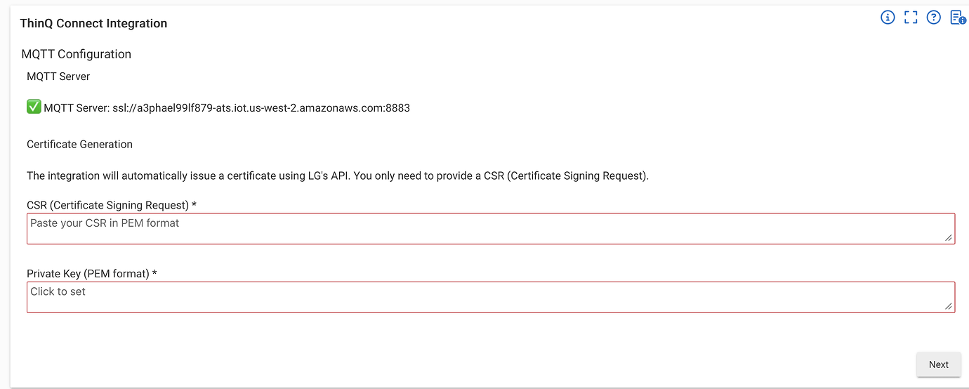

Got it installed including the MQTT stuff. I had seen the README and then I couldn't find it later for nothing. So the link helped a lot.
I was able to do all the steps on a Mac. One thing missing that I figured out was that I needed to download the csrconfig.txt from the GitHub bundle. Then I was able to run the two commands to generate the files.
(For those coming after me that are MQTT deniers like me)
  1. Download the csrconfig.txt to some place like ~/Downloads
  2. cd ~/Downloads
  3. Generate the private key: $ openssl genpkey -outform PEM -algorithm RSA -pkeyopt rsa_keygen_bits:2048 -out priv.key
  4. Generate the signing request: $ openssl req -new -nodes -key priv.key -config csrconfig.txt -out cert.csr

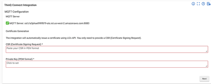

  5. Now you'll be able to open those two files and copy/paste them into the step I showed earlier:
  6. Profit.
Thanks everyone for the assistance. Looking forward to finding innovative ways annoy my wife with the new integration. :slight_smile:
