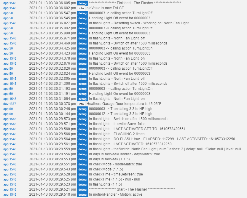

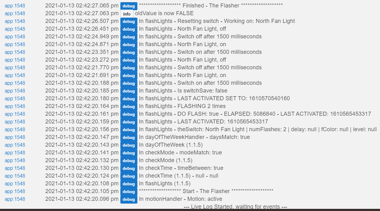

Hi @bptworld, I have a Hunter fan with lights connected to a Bond Hub to Hubitat and am having problems with the lights staying on after they are triggers with The Flasher. Can you look at the logs and see if you see why they stay one. They flash 2 times like I want but then stay on. I tried adjusting the (Milliseconds for lights to be on/off) but they still stay on no matter what I set it too. Thanks.
Looking at your log, the last thing it does it turn the device off. At that point you would have to see if each piece of the chain receives the command and sends it to the next.
Thanks, here are the logs again but with the bond hub logs in there too. Not seeing that it turns it on in the end but it does remain on. app:50 is the bond hub fan light.
