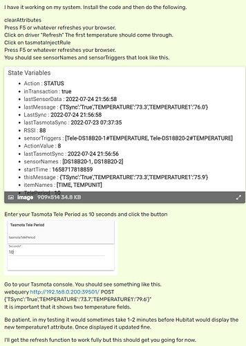

Running and ESP32 with Tasmota 12.0.2, and installed the Switch with Sensor driver. No problem with the driver and the switch is working well.
I've got 3 x DS18B20s and they show up in Tasmota, but I can only get one to show up in Hubitat. My 'Status 8' feedback is: {"StatusSNS":{"Time":"2022-08-10T21:48:36","DS18B20-1":{"Id":"3C01B55682B1","Temperature":53.9},"DS18B20-2":{"Id":"3C01D6075955","Temperature":17.1},"DS18B20-3":{"Id":"3C01D607996B","Temperature":18.6},"ESP32":{"Temperature":53.3},"TempUnit":"C"}}
Have tried a few different iterations in the 'Tasmota Sensor Name' - spaces between, comma & space, comma only, semi-colon & space etc. - but only able to get one sensor to show up.
Any suggestions please?
Hi Ryan, the first release of the driver only handled a single type of sensor and you had to specify the sensor name in the settings as you have been doing.
I have been working on a second version which is not quite finished yet. In this version you do not need to specify the name of the sensor. I had been working with another user to get 2xDS18B20's working at the same time and here is the last piece of that thread with some instructions and comments.
You can find the interim code here but I expect this version will only find 2 of your DS18B20's plus the ESP32.

This what I would do.
- tasmotaInjectRule
- Set teleperiod to something short, like 15 seconds.
- Look at the Tasmota console and you should see activity. Look for the part where it is doing a webquery command and the data it is sending beginning with TSYNC and in there should be the power data.
If it’s not present then it’s probably the rule and you can send me your status 8 output.
If the fields are present with data then the issue is the handling in the driver. To get mor3 info turn the log level up to 3 and wait for the next sync cycle. Should be some clues there.
