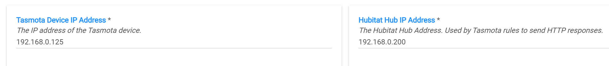

Secondly, if you are getting a Timeout that would indicate a network issue so make sure these values are correct.
If your devices are on different subnets you will need to make sure your routing is correct.

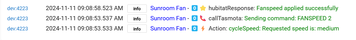

The timeout is weird because my other devices all return the state just fine. Also when I switch the device on and off from Hubitat I get
  • Status : Complete:Fail
