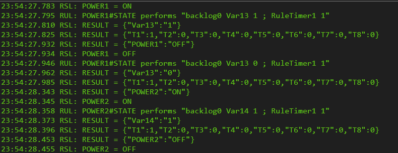

So I'm posting here hoping you guys can help, as I just installed these drivers with a couple of modified Sonoff Dual R2s (dry contact mod, Tasmota Release, 12.5.0) and I've hit a bit of a wall. I dug these R2s out my toybox as I decided it would be great to hack my new Frigidaire extractor hood and integrate it with HE. The crux is that I'm having a hard time capturing all the events I need to make the logic work.
To be able to maintain local control (happy wife) I needed to configure the GPIO buttons (as well as their effect on the relays) acting as momentary switches. The relays are wired in parallel with the existing tactile buttons on the Frigidaire PCB, and I fabricated a new PCB which sits in its place with its tactile buttons linked to GPIO 0 and 9 on my R2s. I'm simply trying to simulate a passthrough push with event capture and pulse output control on top via HE.
Now, if I quickly press and any of the GPIO connected buttons, I can see the On and Off entries appear in the Tasmota console of the respective devices, even though they blipped for just milliseconds; but in the event log of my devices in HE I cannot see any state change:
If I press and hold any GPIO button, maintaining the state of the relay as on for several seconds, then I get an entry in HE.
I was hoping that I can get that momentary state change in HE (albeit with a delay), however it doesn't appear to work this way, and it seems to only send the current state at the time of the next refresh as if it were being polled.

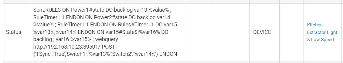

Still hanging on with one bar. Assiming youve done tasmotaInjectRule then rule 3 contains the answer. Rule 3 gets triggered by a change and sends data tu Hubitat. You could modify it with another trigger or write a seperate rule.
Assiming its installed a a single switch then that is the only change that will trigger the sending of data to Hubitat.
Thanks for replying man! Yes I did the tasmotaInjectRule. I have tried setting it up as both a dual relay plug and also multisensor dual relay (with GPIO 0 set to Switch 3, and 9 Switch 4) wondering if the switch change info would get sent as part of the sensor change info, but I got the same result.

Could it be because of the following?

@jon.gillibrand Is this a correct problem statement.
When a user presses either of two momentary switches on other gpios it should cause the state of switch 1 to flip? That change in switch1 is the sent to HE.

I would tweak it slightly to read:
When a user presses either of two momentary switches on other gpios, it should cause the state of switch 1 or 2 (respectively) to flip. The change in state of either switch actioned (albeit momentarily) should reflect in the parent device's event log in HE, allowing for triggers to be subscribed to the SwitchX=ON event in a WebCORE piston.
OK. Then this is how i would approach it.
Install it as a dual switch. Verify that changing switch 1 or 2 on Tasmota is communicating correctly with HE via the driver and vice versa.
I would leave HE ignorant of the other gpios.
Connect the other gpios to two other switches, say 3 and 4.
Lastly you need a rule that says when switch 3 changes state then trigger a change in state for switch 1.
Im doing this on a phone so i cant give you the exact commands but that should work.
