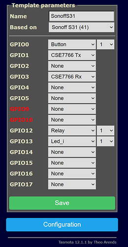

Yes, that is correct. What does this page look like on your device?
This is how it looks

O.K. You need to change the Tasmota config so that status 8 shows those two switches as Switch3 and Switch4. You might need to experiment a but two of those GPIO's should be Switch3 and Switch4. GPIO12 is one of them I think, the other is probably 14.
Repeat the Status 8 command until they should Switch3 and Switch4. Once you have that do a TasmotaInjectRule and it will configure the correct rule and should work after that.
