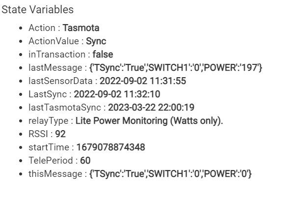

I have a 2-way light switch. I use "https://raw.githubusercontent.com/GaryMilne/Hubitat-Tasmota/main/Dual_Relay_Switch_Plug.groovy" device code. When the device is turned on/off physically the status doesn't change on the tasmota device in habitat hub until I manually press the refresh button (see screen shot) to get the change. This issue is affecting the webcore trigger I wrote to update the virtual switch to control my weird tasmota 2-way switch. Am I doing it right? Is there an easier way? If so, then can you share how I can turn my 3-way switch on or off? I know you are busy. I'll wait for your reply.
