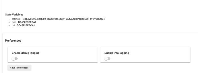

I just meant that I have devices that already exist, and by requiring discovery & adding that way, I'd lose my existing automations. I'll give it a shot by itself. Thank you!
The devices you have installed will not be touched by T4HE unless you tell it explicitly to do so.

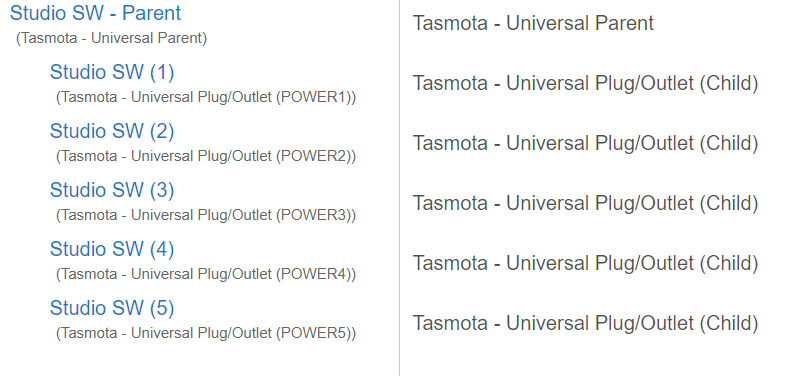

Understood, but I cannot use your app to update the driver on an existing device that is not managed by your app. I have attempted to add the "Tasmota Universal Metering Plug/Outlet" and see this - with no options to update IP, etc. Should I be using a different driver?
Yes, the Universal Parent driver, you will end up with child devices however. All my Tasmota drivers work that way now.
Thanks. Sorry for the questions and my non-standard use.
No worries, these drivers are complex (but very resource efficient) at this point, not running them as intended is not very easy. Hope you can sort it out then

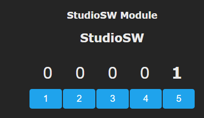

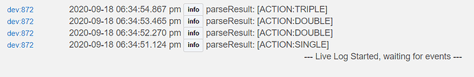

anyone have any luck implementing multi press switches? i have created extra relays and then attached rules to them via tasmota to turn on and off but it keeps having problems when i try to implement into Hubitat since each switch has 4 or 5 switches to monitor. is there a better way to do this?
on button1#state=10 DO publish cmnd/StudioSW/POWER1 TOGGLE ENDON
on button1#state=11 DO publish cmnd/StudioSW/POWER2 TOGGLE ENDON
on button1#state=12 DO publish cmnd/StudioSW/POWER3 TOGGLE ENDON
on button1#state=13 DO publish cmnd/StudioSW/POWER4 TOGGLE ENDON
on button1#state=14 DO publish cmnd/StudioSW/POWER5 TOGGLE ENDON
I am wondering if i can use this to trigger automations instead of needing all switches
this is running on a single treat life wall switch
thanks for any help!
First flashing lite and then Tasmota Hubitat should work. I run that version on my Sonoff Minis. If there's still an issue, do tell me and I'll have a look soon, I have some unflashed Minis I can check.
This should not be hard to add, just never had a reason to before. I'll see if I can build a device with what I have to use this new event.
