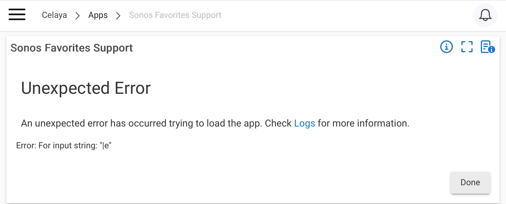

And now yesterday, when I select the Presets option, I get an error message:
Any clues on what is going on?
Thanks for you help.

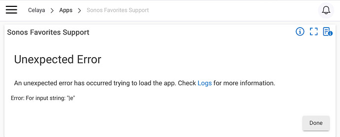

I´m getting a different one:
Edit: I just discovered one of my Sonos speakers was disconnected, and I think that was causing the error message. Unselected it from Section 1, Speakers, and the error is gone, but I just retried with values like 40, 60 or 70, and still play starts at a very low volume.

After a year of working properly, now I am getting an error.
Has anyone noticed this?

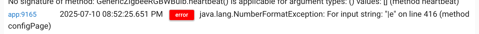

When I press the Presets button I get the following error
And Log file has this error line
This is the code line on the App
Any ideas? Suggestions?

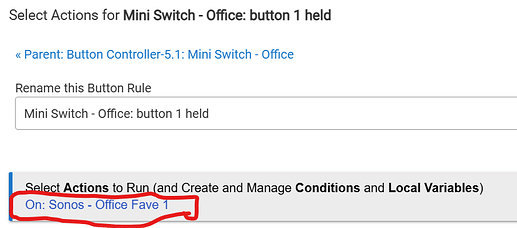

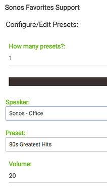

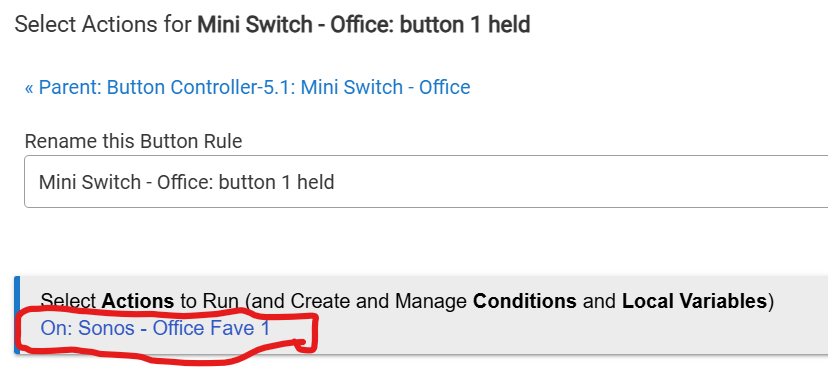

I installed the Sonos Favorites app using the Hubitat Package Manager. I've configured 1 preset using "80s Greatest Hits" (See Fig. 1). Then I configured this newly created "Sonos - Office Fave 1" using an Aqara mini switch (See Fig. 2). However, when I long press the button, the ONLY song which will play is the first song in my music collection (38 Special). I tried changing the preset to different things like Elvis Radio, and this same 38 Special song always plays.
Any ideas what I'm doing wrong?
Fig 1.
Fig. 2

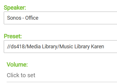

UPDATE:
I added my wife's music library as a Preset, and that worked. So I guess the question is, do you need a URL to the preset, and can radio stations work as a preset?
