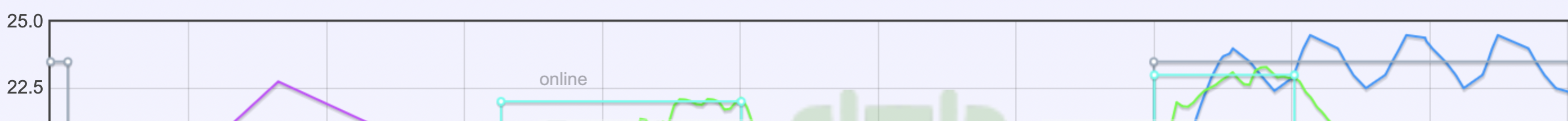

The information i have obtained from the manufacturer of this Sonoff TRV valve tells me there is no PID control. This device is effectively either on or off so is unable to maintain an accurate temperature. Best available is +/- 1 degree. I am informed;
- The valve will be turned off when the ambient temperature is greater than or equal to the target temperature
- The valve will be turned on when the ambient temperature is less than the ambient temperature and by more than 1℃
You can see this from the blue line. the grey line is the setpoint (x-axis lines are 2 hours)
Ironically, you can choose a setpoint to 0.1 degree resolution
Anyone got any workarounds or ways this device's performance can be improved?

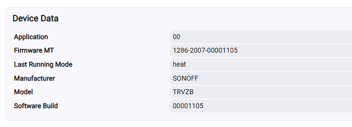

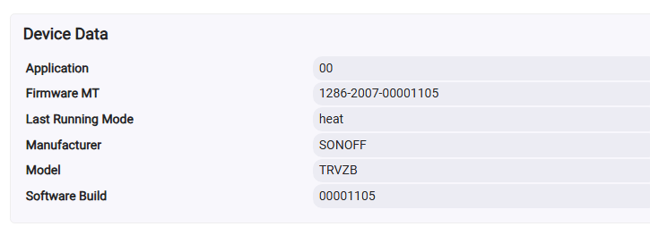

Mine seems to be 1.1.05
